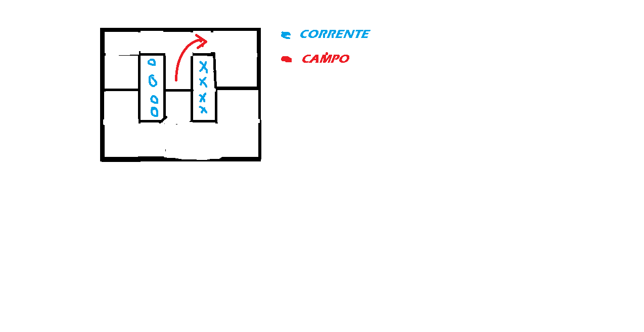

do you think is a good idea to work in 2D?I decided to draw the inductor as in the attached figure. But how to bring my results in 3d?

if you can work in 2D (i.e. a "simple" 2d-axi) its always much better. For multiturn coils you have the new BC's in V4.1, really nice, ut you must read carefully the doc, and look at the equations, these are subtil BC's adding new dependent variables to solve localy for V. But once you master them they will make life far easier for you
