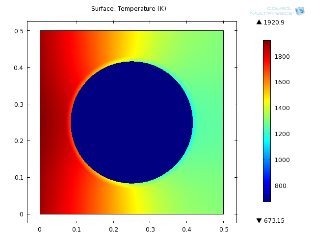

I am trying to simulate a fluid flow in a pipe and this pipe inside cubic box and this box is subjected to heat flux at upper half. I have turbulent flow. The heat transfer from the solid cubic box to the solid pipe to the fluid. I have two basic questions.
What is the different between Conjugate heat transfer and?non-isothermal fluid flow ??I believe that the conjugate heat transfer should selected when the heat transfer from solid to fluid. Please correct me if I am wrong
The second question I tried both of conjugate and non-isothermal fluid but the fluid temperature at the exit is around 450 c (inlet temperature is 400 c) although the pipe surface temperature is around 1600C. It should be more than that
when I run it I get far more at the output (I'm using 4.1.0.154 and I remeshed in normal "physics induced default mesh"
The same results I got please note that temperature unit in keliven , so the inlet tempearute is 673K and the output in the range of 673K to 800K. I think something wrong
By the way how I can calculate the output temperature with comsol . I tried to intergatea the area but the reuslt was wrong
I am sorry to ask this question agian but I really need some help
Fluid temperature at the exit is slightly change which l is annoying me . I am feeling there is a problem when the heat transfer from the solid domain to the fluid domain

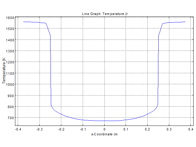

I do not have enough free time to reply just now, but clearly from the profile that I got by using a cut line on the outlet you have a steep gradient, so your fluid has a low heat conduction, or a high speed ;)
to calculate the average temperature you use the average operator on the outlet surface, but I beleive the T proile is more interesting. You add a Data set by right clicking on the data set node
I tried what you said and I reduced the inlet velocity to 0.5 m/s but this did solve the problem. The thermal conductivity for the fluid is around 0.4 W/(K•m). which not that bad.
