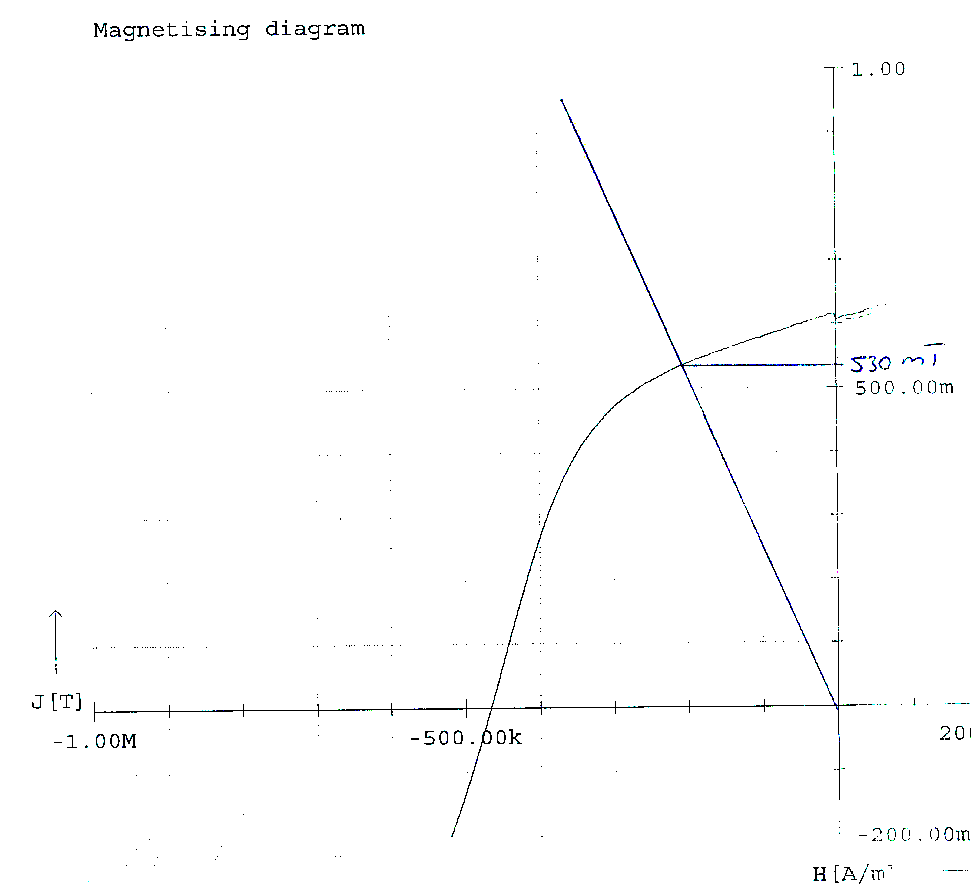

Dear Johan,
Where can I find some details about the "diagonal relative permeability tensor" that you have mentioned in your replies. Also I would like to know where to find out details of some functions that are used in COMSOL such as mf.Bx or mf. By etc. etc.
I wish to use two types of magnets in my design one has Br of 1.47 T and Hcj of 955kA/m and other has Br of 1.18 and Hcj of 2465 kA/m. How do you model these two magnets in the same model. I am working on design of halbach hexapole where i wish to use these to types. can you please suggest me the best way to go about this problem?

Posted: 1 decade ago Sep 20, 2015, 3:27 a.m. EDT
Dear Francesco,
I chose the interpolation function and import the HB curve that I created. Then I define the global function that you suggested, while inputting the expression, if I use HB (since I gave the name the interpolation function as HB) and rest of the expression, the expression remain brown. i.e, comsol does not recognise the expression. Somewhere I am doing the mistake. Can you please tell me the steps to correct this problem?
Nabhiraj
Dear Francesco, I chose the interpolation function and import the HB curve that I created. Then I define the global function that you suggested, while inputting the expression, if I use HB (since I gave the name the interpolation function as HB) and rest of the expression, the expression remain brown. i.e, comsol does not recognise the expression. Somewhere I am doing the mistake. Can you please tell me the steps to correct this problem? Regards, Nabhiraj
