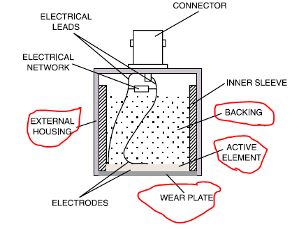

-For the backing part, only impedance is given. Is there any way that I can implement the backing as an impedance boundary on the back of the active element.
-For wear plate (which is a solid material), I have added it to the pressure acoustic and not solid mechanics physics. Is this a correct thing to do? I am not interested in stress / strain of wear plate. I just want to make sure that it correctly transmit the ultrasound waves.
Is there anything that needs to be fixed in the model?
