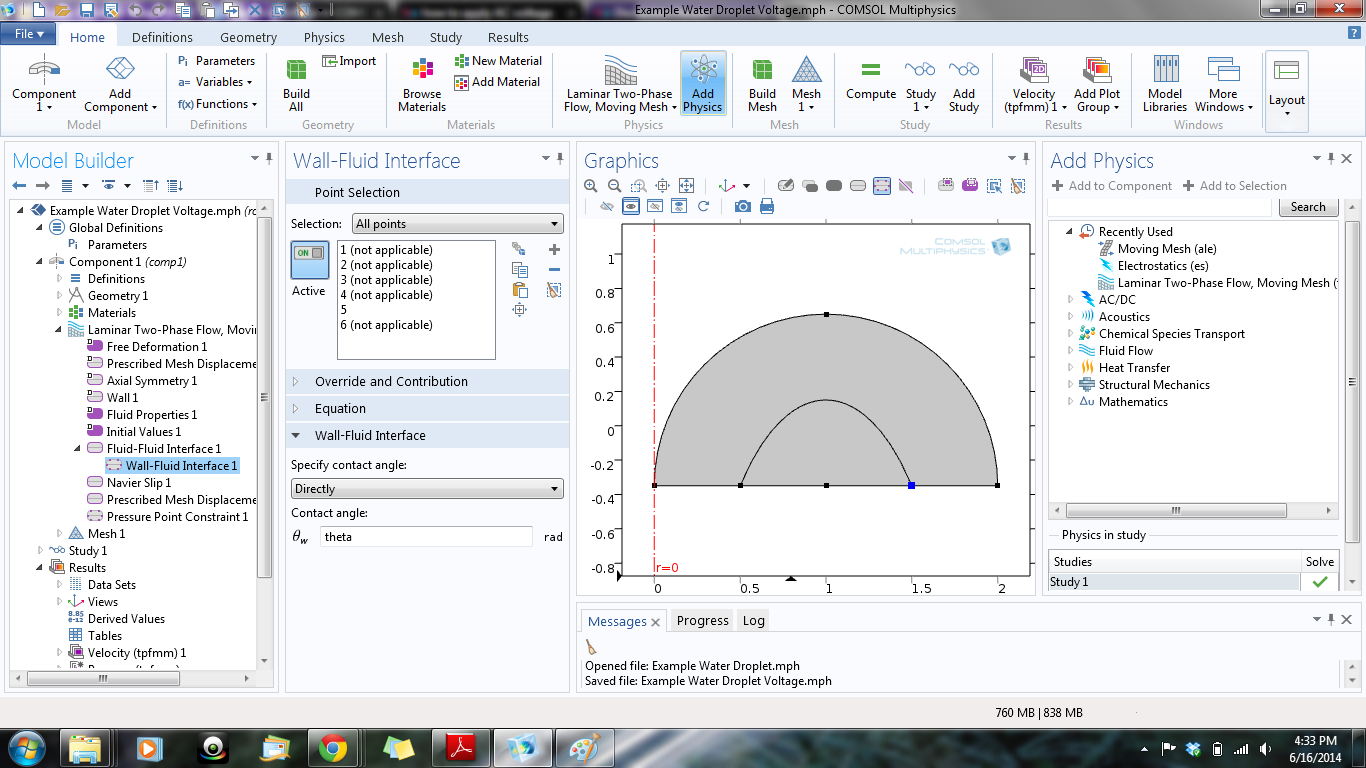

I am following the tutorial of Electrowetting Lens with a different geometric shape. I'm not sure how to apply voltage to this example. Do I need to add EC / ES / ECS physics in order to apply voltage?
Hello, I am following the tutorial of Electrowetting Lens with a different geometric shape. I'm not sure how to apply voltage to this example. Do I need to add EC / ES / ECS physics in order to apply voltage?
