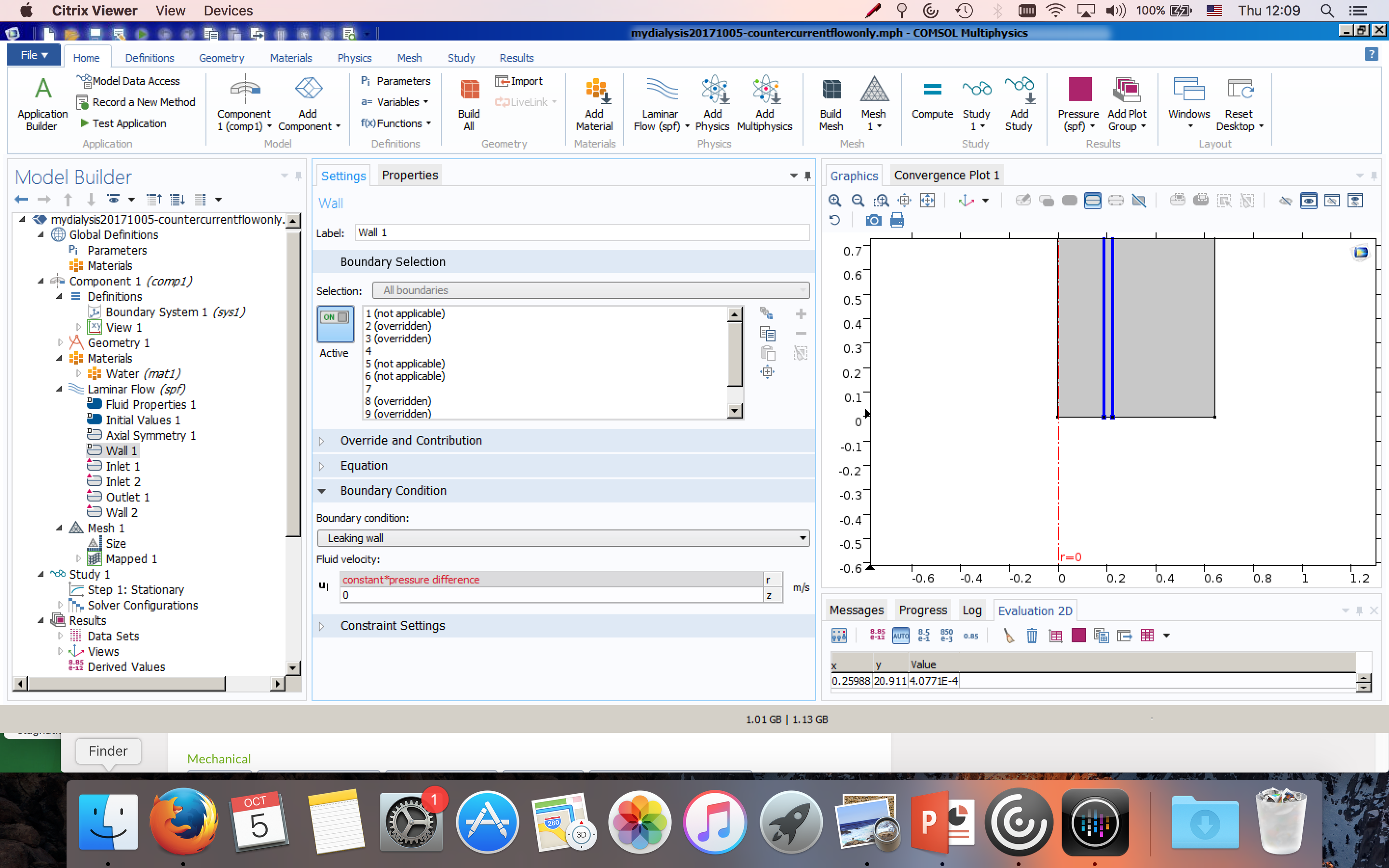

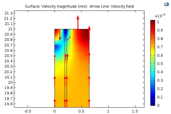

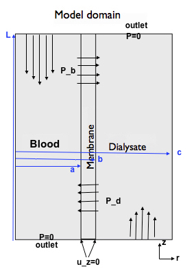

Hi all,
I am trying to build a dialysis model to investigate the flow in the dialyzer. Firstly, I treated the whole domain as a laminar flow, but the result looked badly. Then, I wanted to use the leaky wall boundary condition in both sides of the membranes. However, I need to define the velocity in the leaky wall which is hard because it varies along the vertical distance. Can anyone help me to achieve this model?
Thanks,
Jian
