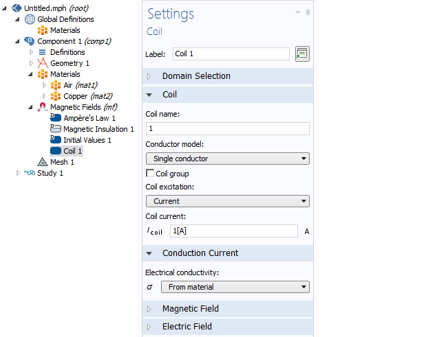

Daniel,
You should use "Coil" feature node, as shown in the attached image. This will account for induction currents in the coil, just make sure to mesh coil appropriately to resolve skin depth, especially if you are working with high frequencies.
Regards, Sergei

Daniel,
Sorry, I overlooked that you are using Magnetic Field Formulation (mfh) physics interface. For the mfh interface, "Coil" feature is not available, but you can excite coil by prescribing the tangential component of the magnetic field on the line around the coil, as explained in the following model from the Model Library:
https://www.comsol.com/model/superconducting-wire-689
Regards, Sergei
