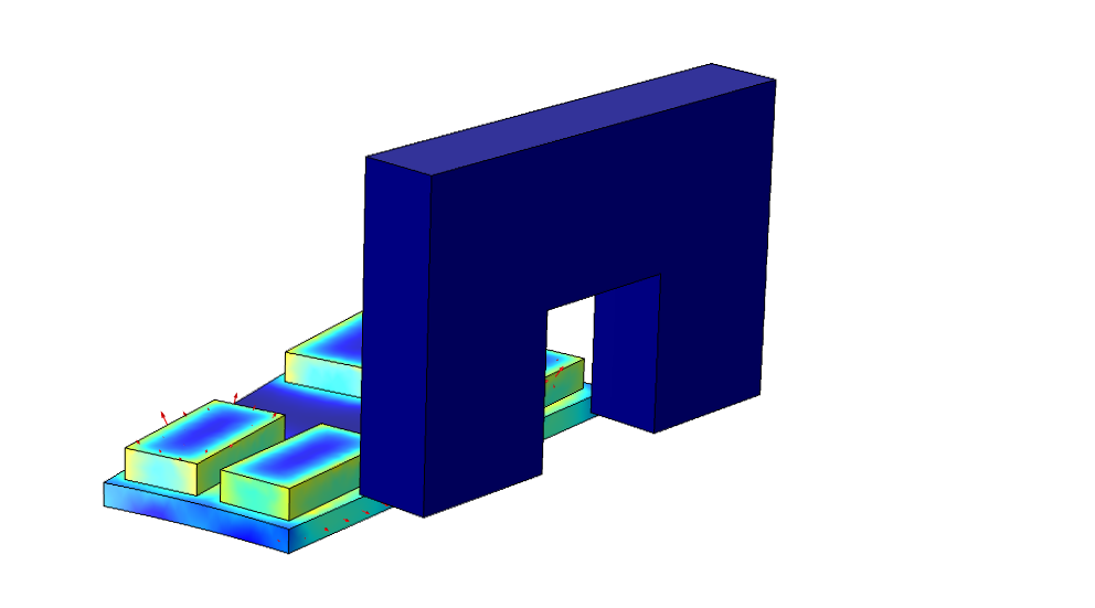

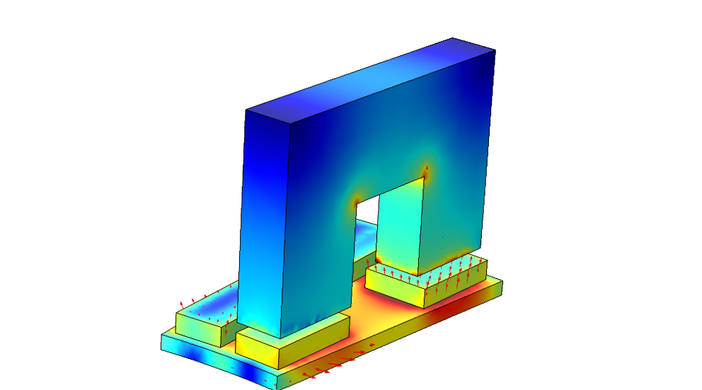

i set up a model of a rotating elctrical machine in 3D. So far the model is working, but i have a problem with the symmetry. I modeled 1/32 of the machine. If i rotate the rotor by several degree the field of the next sector seems to be missing or is in the wrong position. I attached 2 pictures to show you the problem. I think it has something to do with the sector symmetry, but i am not aware, what mistake i am doing.

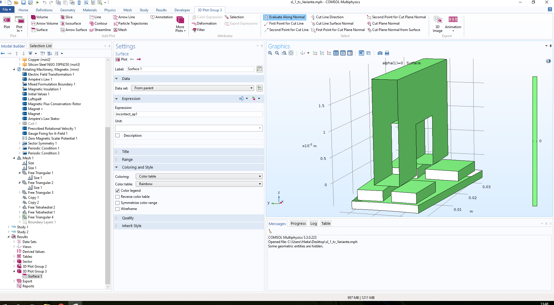

Hallo, i made a plot with the the expression. The first picture shows the identity pair (between U-core and the 4 magnets) and the second the plot with the expression. Obviously i made a mistake, when i applied the axis of rotation.
Is it possible to plot all of the sectors?
Hallo, i made a plot with the the expression. The first picture shows the identity pair (between U-core and the 4 magnets) and the second the plot with the expression. Obviously i made a mistake, when i applied the axis of rotation. Is it possible to plot all of the sectors?
