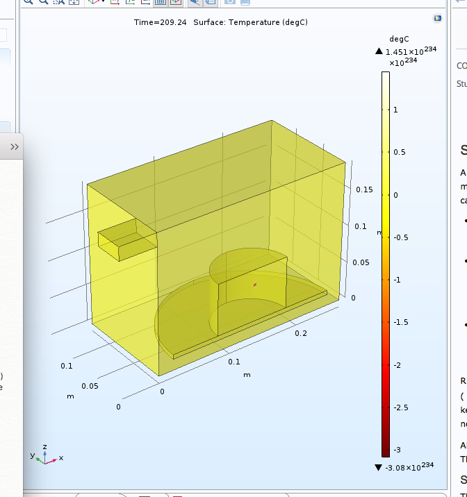

I've monitored what happens while solving the model, and have found interesting things. The temperature sparks occasionally with below cases.
  1. Material is getting really hot with a hotspot - up to 4.056E81 x1.0E81 degC.
  2. The air domain is getting extremely hot - up to 3.456E250 x 1.0E250 degC. In this case, the hotspot in the material becomes coolest point. The temperature of the hotspot is minus here (see the screenshot).
  3. When the time reaches 209 seconds, the convergence value continuously grow as high as 2.6E12, then stop with a singularity error.
I've test a simple swept mesh with the material but it only increase the computation time and get the same error. I will try more options for swept now.
BTW, I see you are using the full simulation model but I use the half simulation model. I believe that there shouldn't be any differences between them.
Warm regards, Sungwoo
