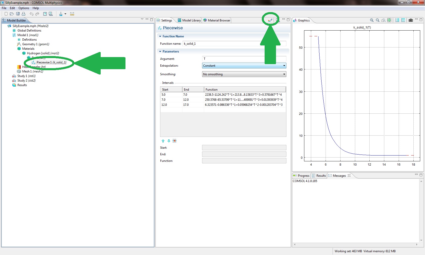

How do I know the exact numerical value of a particular material property that comsol is using?
When I click the material in the library, only a variable name appears. For example, density is rho(T). How can I find the actual values for rho(T)?

you need to load the material, then select the properties and then make your plot.
Thereafter you might "DELETE" the material from your model if you do not like it. It's slightly cumbersome, would be nicer to be able to access the plots ALSO in the model library GUI
Hi you need to load the material, then select the properties and then make your plot. Thereafter you might "DELETE" the material from your model if you do not like it. It's slightly cumbersome, would be nicer to be able to access the plots ALSO in the model library GUI -- Good luck Ivar
Posted: 1 decade ago Apr 21, 2011, 11:31 a.m. EDT
See attached screenshot.
Is there a way to export and save the material property data in the plot ??
[QUOTE] See attached screenshot. [/QUOTE] Is there a way to export and save the material property data in the plot ??
