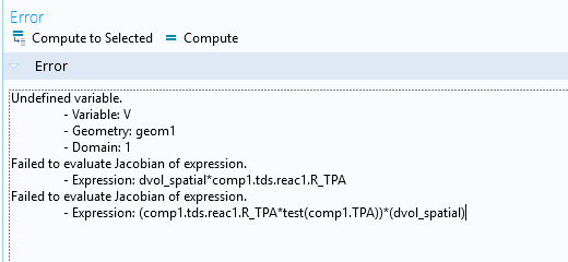

For the equation above, I get the warning "V is an unknown variable" even though it is defined as the dependent variable for the Electric Currents physics.
I have read from another thread that the way to solve this is with 2 different studies: one that solves for V and one that solves the reactions. However, I can not find how to pass the dependent variable V into the reactions study. How is this done?
