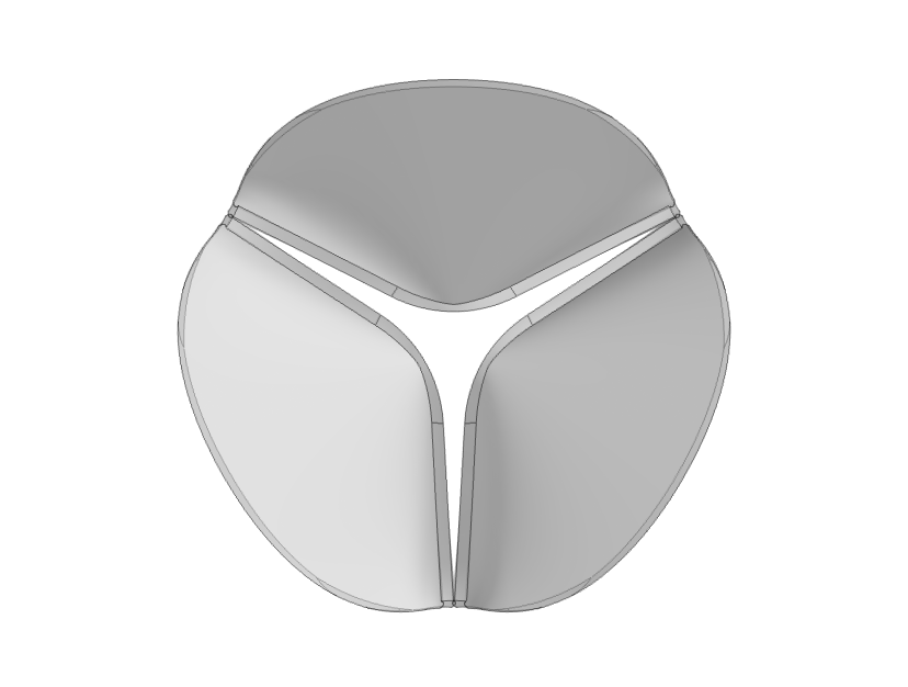

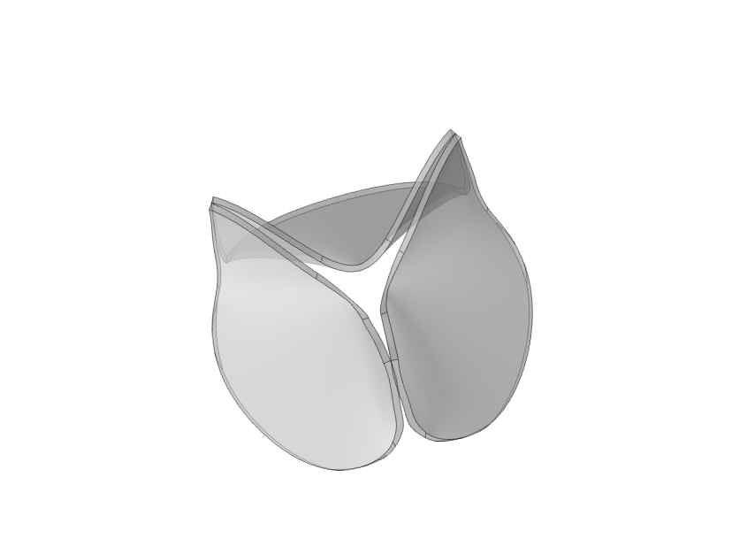

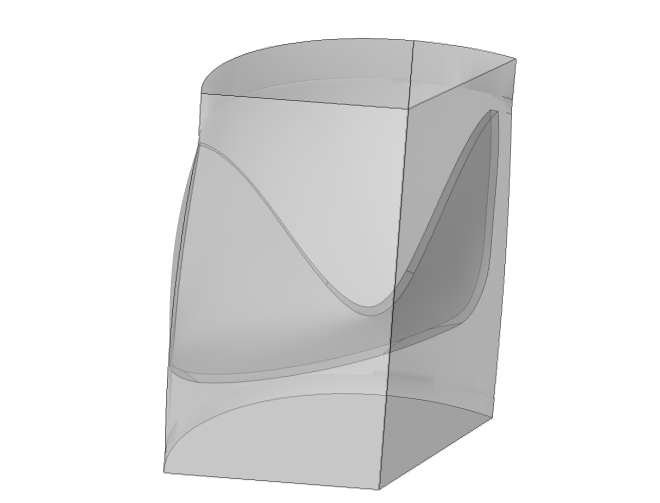

Thank you for replying Henrik it was really helpful.
I have tried the boundary load but since i have a curved and rotated geometry i had to find the exact coordinates of the symmetry plane to determine the acting force. I tried it but unfortunately the solving got stuck on a time step and didnt move on.
About using the contact method, i am using a form union geometry. Does it need to be a form assembly? Also i am a begginer in comsol and i am not sure how to use this method. I think i cant add a block since it is a FSI method and the domains have to be continous.

Hi Elen,
Using assembly mode is not necessary for doing contact analysis. It is mainly useful to avoid that the contacting objects are adjacent in the initial configuration.
The solver problem can be related to that there may be a need for a smooth transition from 'n contact' to high contact force. You could use an expression for the force like exp(-k*gap)
But there is another potential issue: The deforming mesh in the fluid cannot change its topolgy. Thus , you cannot completely close a gap. Often, leaving a small gap is good enough to reduce the the flow down to an acceptable level. If not, a trick that can be used is to increase the viscosity locally when the gap is small.
By the way, please check out this blog post: https://www.comsol.com/blogs/modeling-fluid-structure-interaction-in-a-heart-valve/
Henrik
Henrik Sönnerlind
COMSOL
Hi Elen,
The solver problem can be related to that there may be a need for a smooth transition from 'n contact' to high contact force. You could use an expression for the force like exp(-k\*gap)
