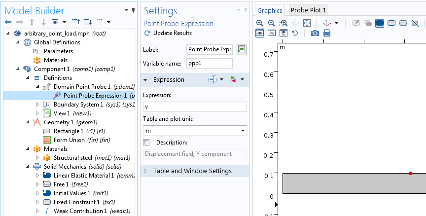

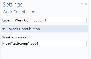

There is however a way to add a load at an arbitrary location (not necessarily even a mesh node). This requires using some more advanced features. In the attached example model, look for
Definitions->Domain Point Probe
Solid Mechanics->Weak Contribution

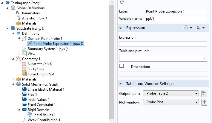

Hello Henrik,
Thanks for helping me. Your attachments are really helpful. But when I compute, it has an error. I think it's the expression of point probe. Could you please help me to check this? I attached my screenshot.
Hello Henrik, Thanks for helping me. Your attachments are really helpful. But when I compute, it has an error. I think it's the expression of point probe. Could you please help me to check this? I attached my screenshot.

The Point Probe Expression should be the displacement component in the direction of the load. In my example, the Y-direction displacement 'v' was used.
More generally speaking (in case someone would like to add a heat source, for example), it should be the degree of freedom which is energetically conjugate to the prescribed 'load' or 'point source'.
