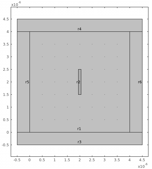

I'm simulating the absorption of a nanowire in vaccum. I started with a 2D model in the RF module. My geometry is a nanowire in vacuum surrounded by cartesian air-PML. I solved the problem for the scattered field. The incident field propagates along the y direction and is either x or z polarized.

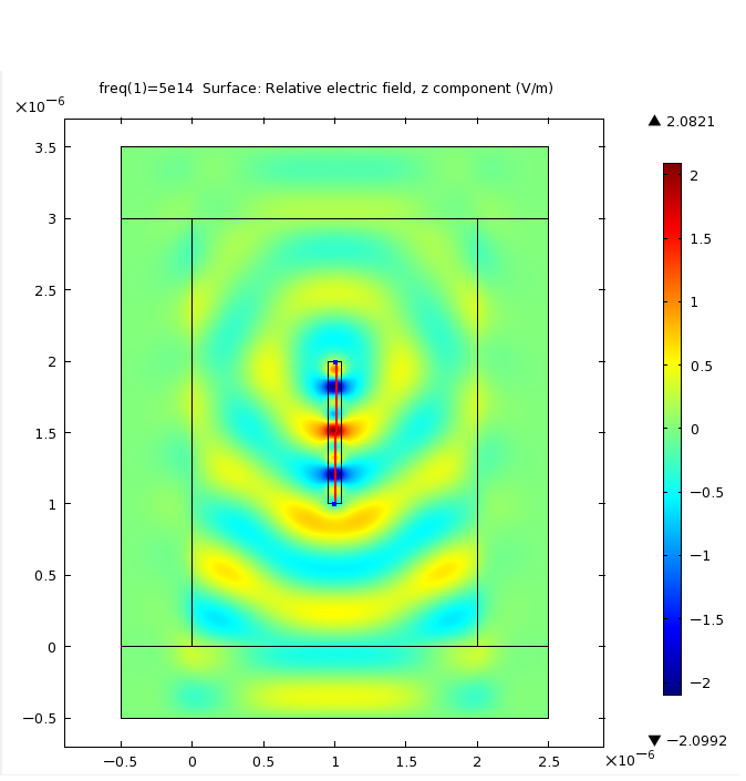

I have no problem with the x-polarization, however when I solve the problem for the z-polarized field, the scattered field is not well absorbed by the PML (see fig in attachment) and it does not change if I increase the size of the PML and/or the mesh size.
Can somebody explain why ?
