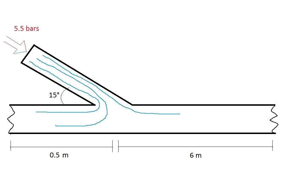

I have to model a flow of nitrogen inside a tube (interior diameter = 12 mm) and all I am given is the inlet pressure (5.5 bars), and the pressure at the other side of the tube is ambiant pressure. The tube is 6.5 m.
The issue I'm facing is that the solver can't find a solution if I just put an inlet and outlet with pressure, no viscous stress as BC. I have a solution with really weak pressure differential (10 Pa) or weak inlet velocity (1e-2 m/s) but these are far away from my own conditions. It's important to notify I tryied both laminar and turbulent flow.

So I have now a solution (thanks a lot) but I doubt of its relevancy (I have a max velocity of 296 m/s), and I wonder how does this 'inconsistent stabilization' option affect on calculations. As a matter a fact my model is slightly more difficult than a simple tube (I used this tube model only to understand the phenomenon) because I have 2 exits (see attached file), and even before knowing the behaviour of the flow, it seems obvious to me that results are false.
