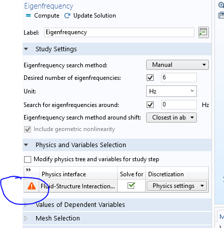

a cantilever beam 50 mm immersed in liquid
i want to extract the frequencies of a cantilever beam of length 300 mm and immersed in liquid the one sixth part of the cantilever length but when i excute the compute in comsol multiphysics it returns an error of the following. so kindly please share me how to fix these errors and warning.

This blog post discusses an analysis similar to yours:
https://www.comsol.com/blogs/natural-frequencies-immersed-beams/
Note that a fluid-structure interaction coupling is not suitable here. The fluid flow interfaces cannot be used for eigenfrequnecy analysis (since Navier-Stokes equations are nonlinear). The current problem falls into the acoustics regime.
