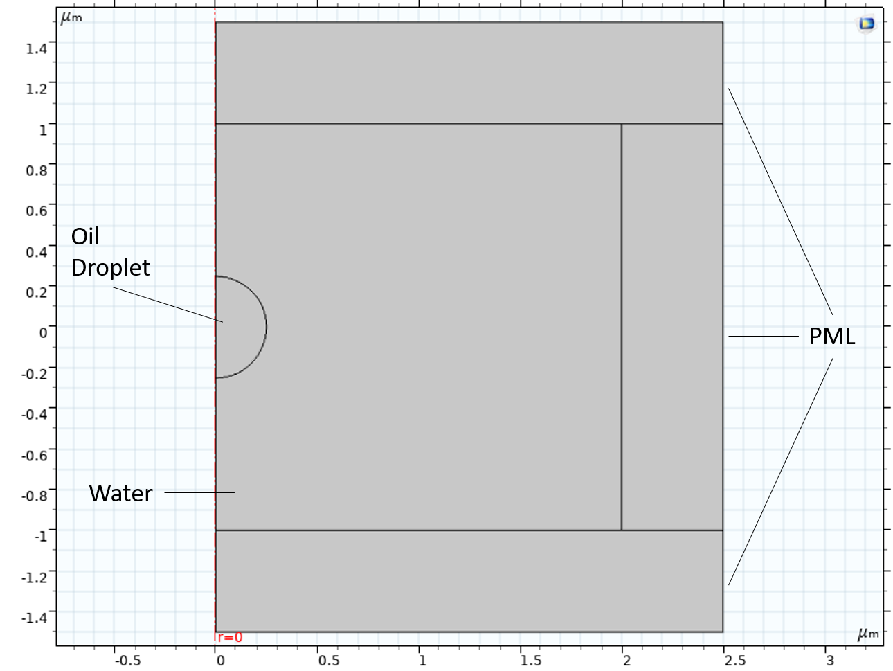

thank you for the advice. I checked out the model you suggested before starting this post, but unfortunately it didn't solve most of my doubts, such as:
- How can I model the pressure that will deform the bubble? Should i use the acoustic module, apply the input pressure to a boundary and perform a time domain study?
-How can I model the deformation of the oil droplet? I know that the structural mechanics module can show the deformation of an object, but it should be a solid. Can iI obtain the wanted result with the multiphase flow modeling?
Thanks,
Matteo
