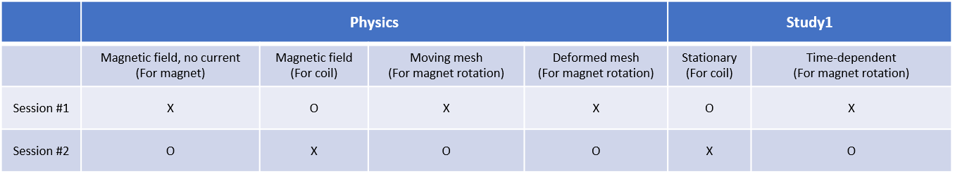

I've simulated rotating permanent magnet(Time Dependent) inside a coil with flowing current of 1A(stationary) and trying to retrieve the data of magnetic torque and force that is applied to permanent magnet in time variant.
I added 2 different physics, 'Magnetic Fields, No current(mfnc)' and 'Magnetic Fields(mf)' for permanent magnet and multi-turn coil respectively.
A 'moving mesh' and 'Deformed Geometry' study is also added to make permanent magnet's rotation.
A single mesh is built for all geometry including permanent manget and coil.

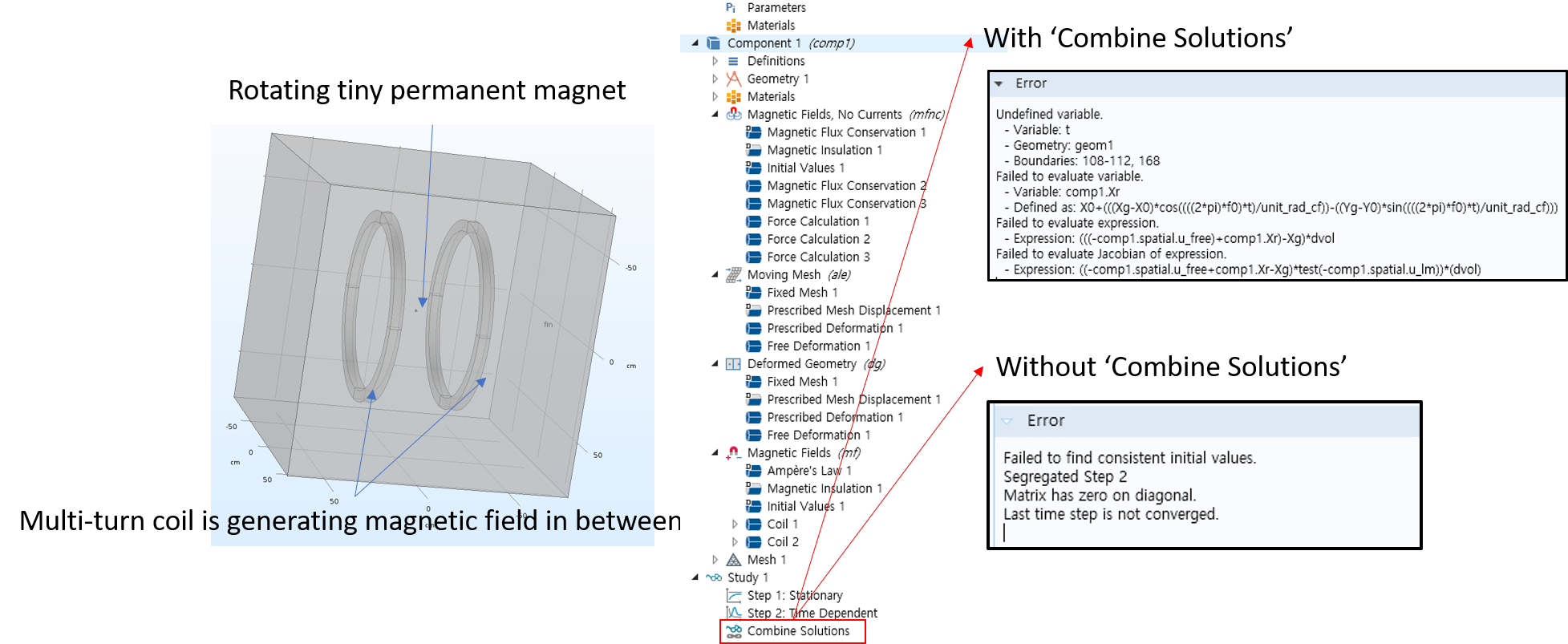

HERE IS THE ISSUE. I arranged 'stationary study' and 'time dependent study' in a row and applied the 'combine solution' but ended up with initial value error.
I need a comment in a big perspective, how to make this simualtion framework. If this simulation that I am trying to do understandable, could you please give me a help?
(Attached picture is schema of my simulation)
