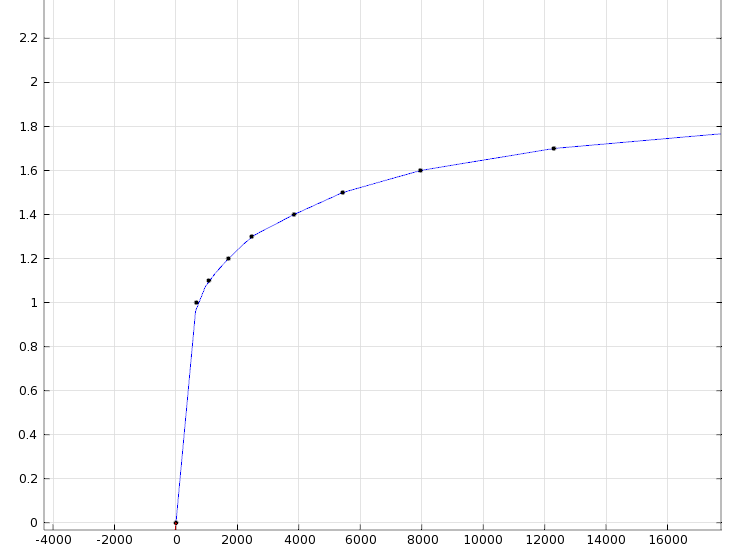

Thank you very much for your help. I changed the air region and I do get a much better and reasonable result compared to Ansoft Maxwell. However, I still don't quite understand why my two simulations using different material with other boundary conditions exactly the same are so close to each other. There's slight different in Magnetization however when I plot B curve the difference is unnoticeable.
I'm concerned if BH curve is actually used in the computation processing since the BH curve for the two materials are complete different. Thank you. Any advice will be very much appreciated.

that is good to hear ;) the two software should agree, for similar models
I find the two rather different, try to plot them on the same curve.

I actually do have a question about the saturation. Because the embedded material property for iron has the BH curve that doesn't saturate till B reaches around 1T. Since the peak value in the middle of the solenoid is only 0.6T, does it not mean the core material for both cases have not saturated yet? Thanks.
Charles
I agree that it did not look like it was saturating, but again I looked rather quickly ;)
Nrmally 0.6 T in the midle should not imly much higher for the rest of the module (in steady state)
