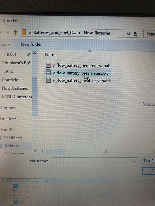

I am a beginner in using COMSOL 5.0. During my first practice, I discovered the file, "v_flow_battery_membrane_variables.txt" is missing when I wanted to define the variables for membrane. Picture attached below
Please what's your advice?

The version 5.0 of the step by step instructions for the Vanadium Redox Flow Battery do not involve a file by the name v_flow_battery_membrane_variables.txt . I suspect you are looking at step by step instructions intended for the current version (5.4) of the software, see https://www.comsol.com/model/vanadium-redox-flow-battery-14153 . Your COMSOL rep should be able to send you the 5.0 version of the instructions; you can contact them through this link.
