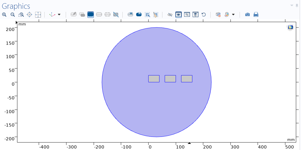

Jens, I tried drawing the circles you said, it successfully created the shared boundaries but not the boundaries I need. Now I have another question, while I defined the materials of different domains. In material>>air, I found the domains of magnet are covered by the air domain. The pic I uploaded is the correct definition of materials. You can see the pic in purple color that are domains of air. But in my model, I scanned the definition of the air domains, I found the purple color was covered the magnets. How can I avoid this poblem?
