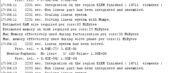

I'm interested in the intermediate steps too, to decide whether to kill the simulation or nor.
How can I save the log in an external accessible file?
Something like the attached image.
It would be great!
