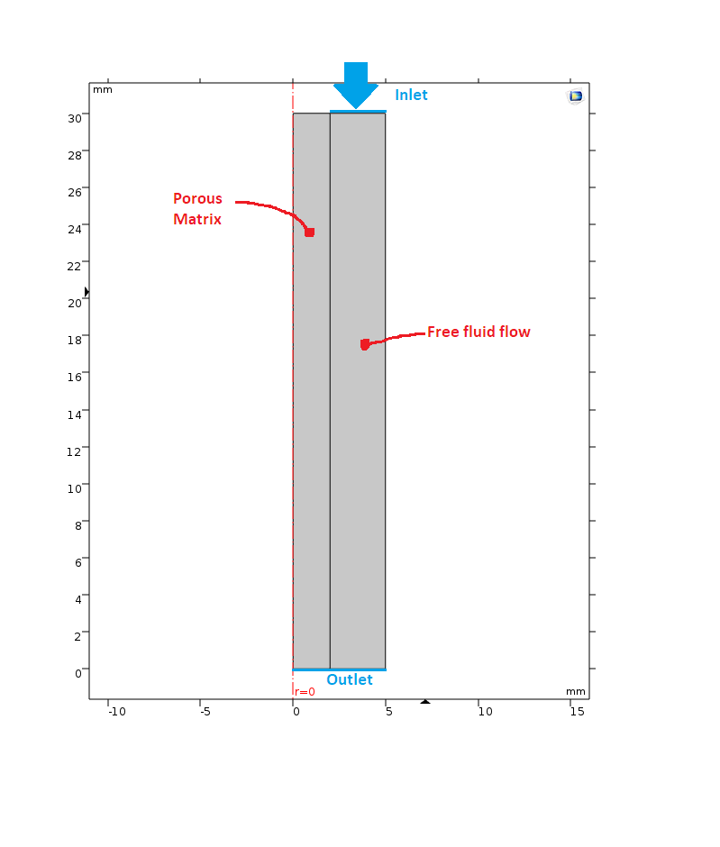

I'm looking to simulate a steady state system where a fluid flow is inducing a velocity on an porous matrix (see attached picture).
I have managed to model a moving solid using the Fluid-Structure Interaction multiphysics, and I have also managed to seperately model a non-moving solid being infiltrated by the fluid using the Free and Porous Media Flow physics. However I am not sure how to start in order to model both of these physics happening at the same time.
I have attached a picture of the problem.
Any help would be greatly appriciated.
