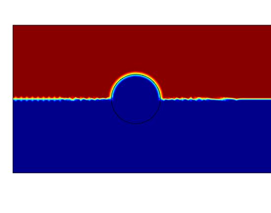

Hi all, I'm simulating mixing of two streams with a droplet (please see the attached image), which means that I don't want COMSOL to solve tds inside the droplet (the black circle in the image.) I've tried some ideas but it doesn't seem right and two streams fall into the droplet actually. I have the level set module to track the droplet interface. Any ideas? Thanks, Milad
