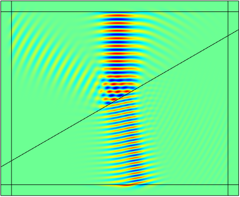

When you set n2=1 (no material present), you can see a nice Gaussian beam. When you set n2 to something else (a tilted material is present), then you expect some reflected and refracted wave, but the solution I see is clearly not physical (one refracted beam in roughly the right direction, one refracted beam as if n2 is negative, and no reflected beam).

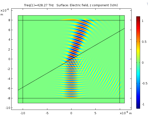

Is the attached figure what you expect?
correct. At least qualitatively it makes more sense to me. When I run the above simulation I posted, I get the 'wrong' E-field in the attached fugure.
The default direction of incidence is positive y, so the Gaussian beam illuminates from the bottom to the top. That's what you got. The easy fix is just the change of sign for the wavevector.
