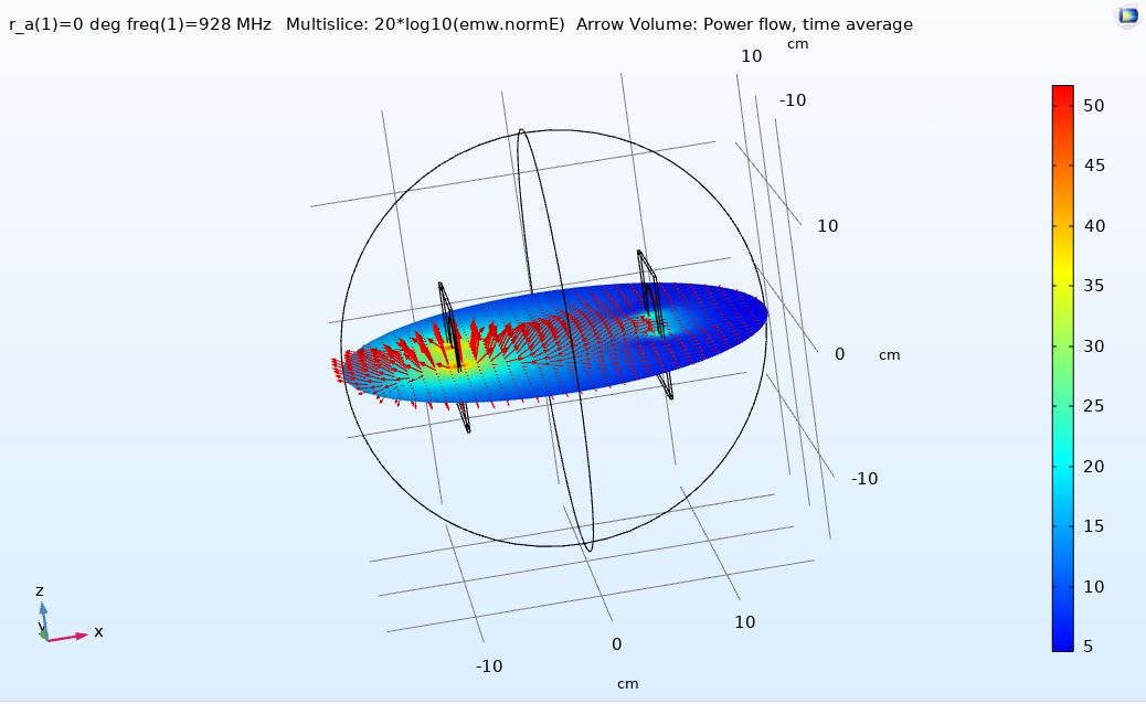

Hello, I have designed a wirelesss power transfer system using loop antenna in comsol multiphysics 5.4 . I have computed the S-parameter but I am having problems finding the efficiency of the system. How can I find the efficiency?

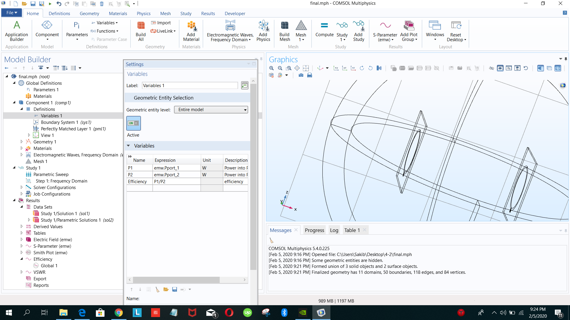

Hello Sir, How are you doing? You answerded to find the ratio of output power to input power. I have done that but can't find the efficiency on comsol. I have attached two files. Can you please take a look at them and help me with the situation? Thank you in advance.

Create a 1D plot or a table that plots or tabulates the variable you defined. Some of the Comsol-supplied example files show how to create tables and plots of computed results.
