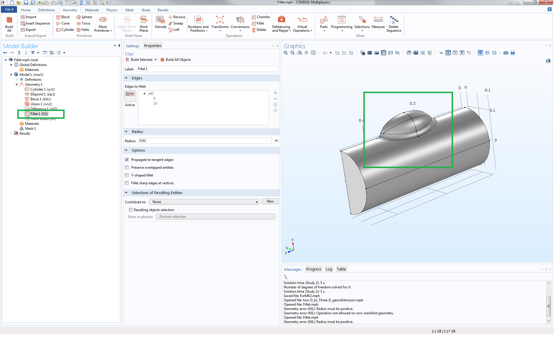

But I found out that the radius of a fillet is also available via a variable in SolidWorks. For a dimension in a sketch, you would typically use "MyLength@sketch1" in Comsol. For a fillet, you can use "D1@fillet1" (where fillet1 is the name of your fillet). It's as simple as that :-)
