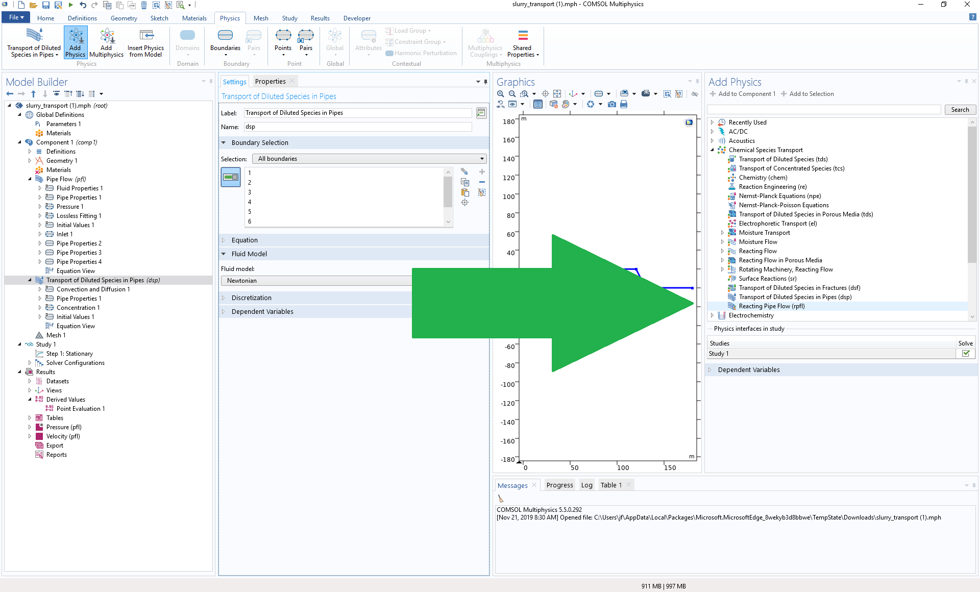

The Pipe Flow Module does also offer an interface for modeling advection diffusion (and even chemical reactions if you need that), see attached screenshot. This link gives an overview of the Pipe Flow Module, and you can use File > Help > Documentation within the software to reach its detailed documentation, assuming your license includes that module. I don't know of a ready-made tutorial that illustrates that specific interface on the type of geometry you are working with, but all the Pipe Flow Module's interfaces follow the same general philosophy so the tutorials you'll find in the Application Libraries (also found under the File menu) for the Pipe Flow Module should still be helpful to you.
You can check whether your license includes the Pipe Flow Module by going to File > Used and Licensed Products.

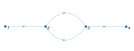

                                                    Hi Jeff,
Thank you. I could locate the Pipe flow module and follow the documentation given for pipe flow.
I did the following:
I followed the tutorial that you had shared to create the pipe geometry .However, I
couldn't successfully run for velocity.
For my system, I'd changed the diameter of the pipes. I wasn't able to change the length of pipe sections though.
I've the following doubts regarding the coordinate specification,
I don't understand why certain coordinates are mentioned twice. e.g. 80 0; 80 0. Is it required to mention twice when there is a curve?
Secondly,
I've used the Add Physics icon to add simulate convection and diffusion of species in the pipe section. Here, I couldn't figure out how the velocity has to be specified.
I'm simulating 1-dimensional system. The velocity tab requires x and y velocities.
In the documentation it is actually mentioned, "These systems can easily be coupled to other systems that cannot be described using the approximative methods in the Pipe Flow Module, but require a full description of the system's physics in 2D or 3D". If I am interested in simulating the fluid flow in 1D, can I simply set y velocity to zero?
