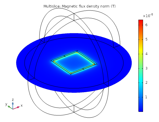

I'm new to comsol I have to build a rectangle coil and monitor magnetic field arround it. Coil type is not circular.
So i tried Conductor model : Homogenized multi turn Coil type : Numeric i'm stuck here . can anyone help ?

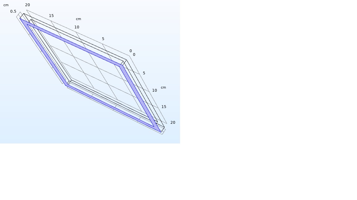

Sanchayan,
Attached is working model.
Sergei
Sanchayan, Attached is working model. Regards, Sergei

@Sergei Thanks for your time, but still i have issue. I'm simulating this result for the purpose of building a Gradient coil for MRI. Means i will end up using multiturns of coils. Your setting on conductor model is : Single conductor. How to implement it on multi turn coil.
When i implemented it on multi turn coil , i get the error " Could not determine the center of the circular coil ".

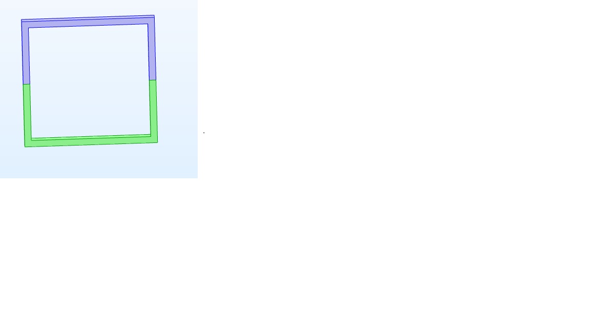

Sanchayan,
Attached is multiturn coil.
Sergei
Sanchayan, Attached is multiturn coil. Regards, Sergei

You have answered the original question. Big thanks.!!! Now im trying to build by myself more complex model.
Can i ask a geometry question. At your model the selection happens on whole domain attribute. when im developing the selection happens on faces of the shape attribute. Where im doing it wrong.
Regards
>Sanchayan, > >Attached is multiturn coil. > >Regards, > >Sergei hei You have answered the original question. Big thanks.!!! Now im trying to build by myself more complex model. Can i ask a geometry question. At your model the selection happens on whole domain attribute. when im developing the selection happens on faces of the shape attribute. Where im doing it wrong. Regards

Hei.
I have sorted the issue. big thanks once again.
