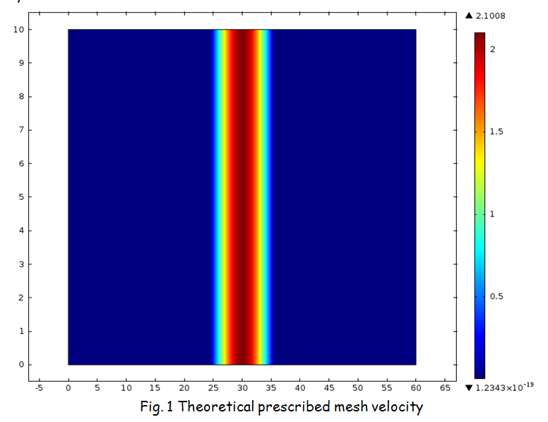

I ‘m building a simple model based on the “heat transfer” module and the “ALE” module. The geometry is a simple rectangle. In the heat transfer node, the upper boundary is a heat flux BC, and other three are thermal insulation. In the ALE node, a prescribed normal mesh velocity is implemented on the upper boundary, other three are fixed.
Recently, I have encountered some problems relative to the ALE. Due to this reason, I deactivate the ALE module and solve the model where there is only a “heat transfer” module with some local variable to see where the error and mistake is (to ensure whether there is any wrong variable definition). In the ALE node, a “prescribed normal mesh velocity” is implemented on the upper boundary, where the ”normal mesh velocity Vn” is setting “to roeB_r+rolB_r” (m/s), After solving the model without the ALE, the theoretical normal mesh velocity (I defined a local variable with the expression of “roeB_r+rolB_r” to visualize the variable) is illustrated in the Fig. 1. In the Fig.1, we can see there should be a moving of the boundary.
(see the Fig. 1 in the attachment)

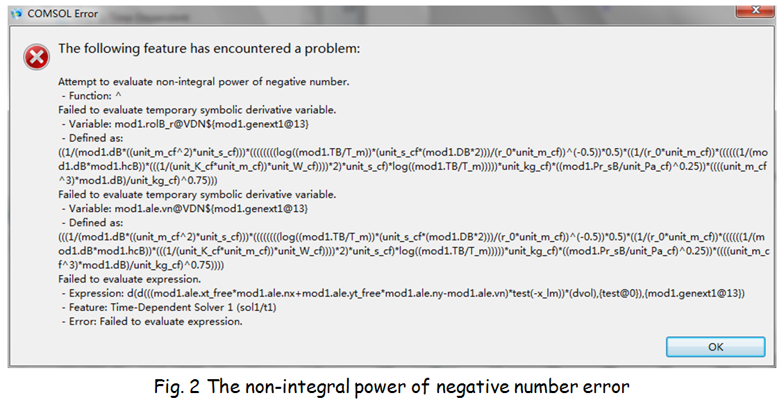

But when I activate the ALE node, the following error occurs (also as the Fig.2 shown).
Attempt to evaluate non-integral power of negative number. - Function: ^ Failed to evaluate temporary symbolic derivative variable. - Variable: mod1.rolB_r@VDN${mod1.genext1@13} - Defined as: ((1/(mod1.dB*((unit_m_cf^2)*unit_s_cf)))*((((((((log((mod1.TB/T_m))*(unit_s_cf*(mod1.DB*2)))/(r_0*unit_m_cf))^(-0.5))*0.5)*((1/(r_0*unit_m_cf))*((((((1/(mod1.dB*mod1.hcB))*(((1/(unit_K_cf*unit_m_cf))*unit_W_cf))))*2)*unit_s_cf)*log((mod1.TB/T_m)))))*unit_kg_cf)*((mod1.Pr_sB/unit_Pa_cf)^0.25))*((((unit_m_cf^3)*mod1.dB)/unit_kg_cf)^0.75))) Failed to evaluate temporary symbolic derivative variable. - Variable: mod1.ale.vn@VDN${mod1.genext1@13} - Defined as: (((1/(mod1.dB*((unit_m_cf^2)*unit_s_cf)))*((((((((log((mod1.TB/T_m))*(unit_s_cf*(mod1.DB*2)))/(r_0*unit_m_cf))^(-0.5))*0.5)*((1/(r_0*unit_m_cf))*((((((1/(mod1.dB*mod1.hcB))*(((1/(unit_K_cf*unit_m_cf))*unit_W_cf))))*2)*unit_s_cf)*log((mod1.TB/T_m)))))*unit_kg_cf)*((mod1.Pr_sB/unit_Pa_cf)^0.25))*((((unit_m_cf^3)*mod1.dB)/unit_kg_cf)^0.75)))) Failed to evaluate expression. - Expression: d(d(((mod1.ale.xt_free*mod1.ale.nx+mod1.ale.yt_free*mod1.ale.ny-mod1.ale.vn)*test(-x_lm))*(dvol),{test@0}),{mod1.genext1@13})
I’m quite puzzled about that, I can solve the model and evaluate all the relative variables without the ALE. This means there is no any wrong with the parts except the ALE section. While the above-mentioned error “fail to evaluate the relative variable” puzzles me a lot.

for me 2 have at least two issues
1) you coordinate transform is on the spatial frame (dependent on the solution), I expect it to be on the Reference frame (fixed in space), then it's strangely orientated, but as you seem to use only "r" its probably OK)
2) then your Gaussian beam has an amplitude of >1:1E11 that is a lot, do not forget that the binary representation of number has a limited resolution hence a limited dynamic check the value of "eps" and compare to 1, and do not forget that you need sqrt() and ^2 to resolve your physics
3) I fear that you extrusion coupling is not working as expected, but I'm not sure, neither why not ...
4) you remain with a sqrt(-1) issue, either because some of your formulas are complex, or because during the solution something goes negative. This often happens with the diffusion solution in time stepping when the ratio between the time steps, and the mesh density are not sufficient to resolve steep diffusive thermal gradients, have you checked the diffusivity of your material nad the related mesh size and thermal properties.
FEM as any "sampling" solver scheme needs to respect the traditional sampling criteria: at least 3 samples across a gradient to resolve it (à la Nyquist for time series)
So for me "nothing is wrong with ALE" ;)
