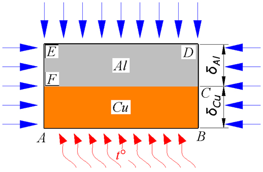

I'm trying to solve a problem of modeling of thermal stresses in layer compost materials. I need it for my master's diploma.
I attached a file that describes the heating conditions of my composite. So as you see my task is a simple 2d task.
When I set boundary conditions for Solid Mechanics I set point "A" as a "Fixed Constraint" and point "B" as a "Prescribed displacement" in y direction = 0.
