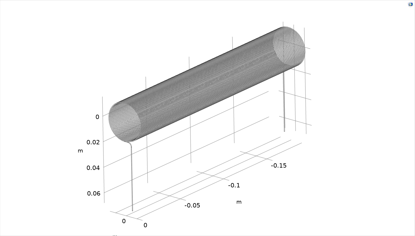

I have a couple suggestions:
1) there is a blog post here that should help with meshing of a coil: https://www.comsol.com/blogs/improving-your-meshing-with-partitioning/
2) I tried to mesh just the coil part and it took a long time. Something might be wrong with the predrawn file. I would suggest to draw this native in comsol. There is a helix function so you should be able to mimic what is wanted.
3) I would suggest you make the air box a little bigger . You will also need at least one coaxial port at one end of the inductor. This you can do with a workplane. You can use two coax ports if you want as you can translate between s-parameters and ABCD parameters to get a series impedance.

Based on the figure you posted, that's an awfully large number of turns of closely-spaced fine wire. I'm not surprised you would have trouble meshing that wire with sufficient detail, within that volume. Anyway, you might want to step back a little and try modeling a similar geometry with fewer turns of more widely-spaced and thicker wire first, just to ensure that you can actually do it, and then compare your model results to the expressions that people used to use before they were blessed with such powerful computers and software! Specifically, the following references, among others, may also be of some interest to you:
https://nvlpubs.nist.gov/nistpubs/bulletin/04/nbsbulletinv4n3p369_A2b.pdf
https://nvlpubs.nist.gov/nistpubs/bulletin/08/nbsbulletinv8n1p1_A2b.pdf
https://www.bookdepository.com/Inductance-Calculations-Frederick-W-Grover/9780486474403
Good luck.
