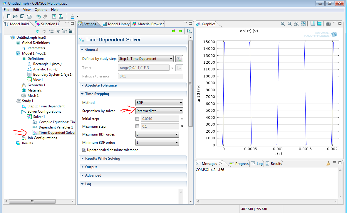

And do not forget to use "time Stepping" Intermediate, else your pulses will disappear

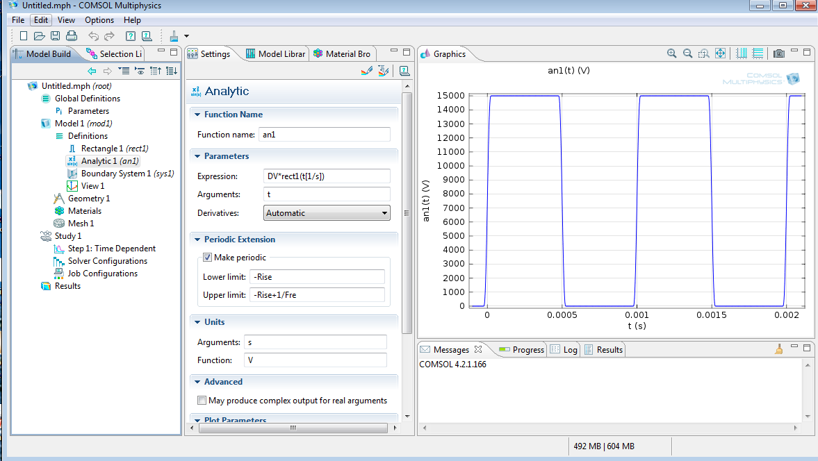

So that , the first problem to creat the pulse train for 4hours as follows:
i get rec1() ( lower limit= 0; upper limit= .5 E-3, transition= 20 E-6)
then , i add analytical function an1() from function
expression: 15000* rect1(mod(t,1E-3))
Argument : t
periodic fun.: make perid
lower limit : 0
upper limit: 3600*5
plot paremter;
Arg.: t
lower:0
upper: 3600*5
when i plot it , i don't receive my target
so what can i do?
--- another question (sorry for taking you time) what did you mean by time stepping in first reply? how can i use it in Comsol?
finally , really i am very gratful for you
Here are some advises:
if you choose "make periodic", you do not need the "mod(t,1e3)", just "t" as the mod is already there
if you want to look at the plot, put Plot parameter 0 0.004 to see some details, if you ask for 12 million oscillation your screen resolution is not good enough. The plot Parameters is only for the visualisation of the plot of your function, nothing to do with the solver sequence.
Now what I proposed was to calculate the average power and apply that, without the small oscillations, you will get the same overall T shape.
Do not forget to define a time stepping for the time siler that sees the short rise and fall times

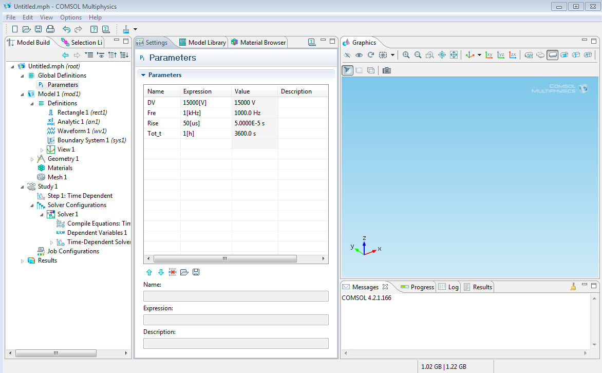

i tried to make your notes
1- i changed DV to variables ( as it described as an1(t[1/s])
2- i make the edge 4 flat
i find singularity in running simulation
i don't know why?

first in your meshing, delete the Free Triangular 1 (and leave the 2), (note: test later the mesh sensitivity, by setting the size to extremely fine, and then custom Resolution of narrow region = 3)
Then in your Global Definition rectangle type your Parameters to Lower Limit 0 + 0.1E-4/2 and Upper limit 0.5e-3+0.1e-4/2 and leave the smoothing to 0.1E-4
Like this your an1(t=0) starts at V=0 and not half way up 8000V, which is too much for the solver
Then it works better

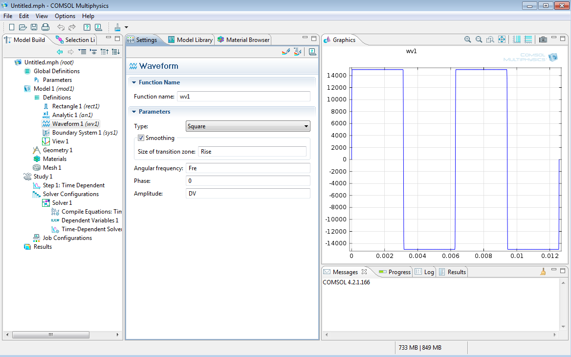

I tried to complete my model but i faced two problem
1) when i make my pulse train , an error occured and seis no set of argumenr despite of putting the rang of t !!!!
2) the second problem , is when i changed the variable to wv1 (sinewave) and try to solve the model (just to see its behavior) it gives me error and i don't know why?
