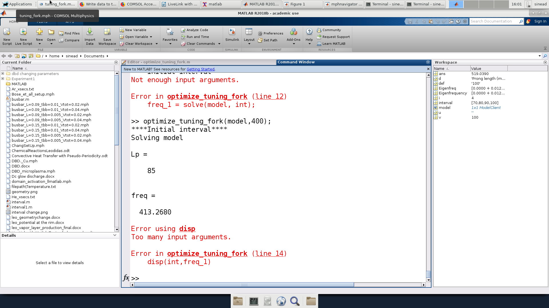

I get the attached error.
Error using disp
Too many input arguements.
Error in optizimse_tuning_fork (line 14)
display(int, freq)
Any help would be much appreciated...
