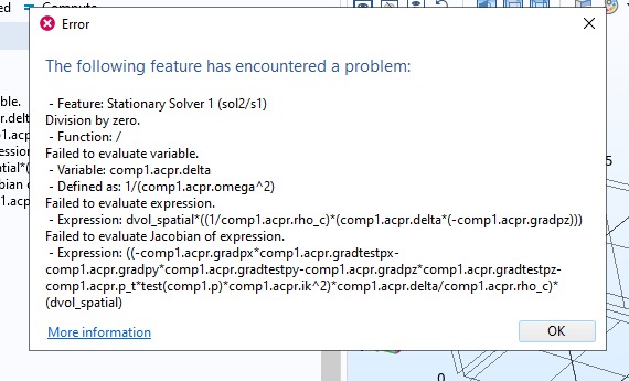

I need some help. I'm tring to do a basic simulation: I need to calculate how much energy pass through a simple concrete wall.
I did the following geometry: a box filled with air and in the middle a concrete wall. I have selected the frequency domain study on the acoustic-solid interaction module. I inserted the pressure on some edge and a rigid wall on the other air wall and on study settings, I put the frequency Range (0,100, 1000). I made the mesh and when I try to evaluate values ​​I'm with the following error (image attached):
Division by zero. - Function: / Failed to evaluate variable. - Variable: comp1.acpr.delta - Defined as: 1/(comp1.acpr.omega^2) Failed to evaluate expression. - Expression: dvol_spatial((1/comp1.acpr.rho_c)(comp1.acpr.delta(-comp1.acpr.gradpz))) Failed to evaluate Jacobian of expression. - Expression: ((-comp1.acpr.gradpxcomp1.acpr.gradtestpx-comp1.acpr.gradpycomp1.acpr.gradtestpy-comp1.acpr.gradpzcomp1.acpr.gradtestpz-comp1.acpr.p_ttest(comp1.p)comp1.acpr.ik^2)comp1.acpr.delta/comp1.acpr.rho_c)(dvol_spatial
What I must to change?
Thanks!

My guess is that the zero frequency you start with is not valid in frequency domain.
Cheers Edgar
Cheers Edgar
It was not enough to evaluate the results. The same mistake happened.
>My guess is that the zero frequency you start with is not valid in frequency domain. > >Cheers >Edgar It was not enough to evaluate the results. The same mistake happened.

Well, as I said this was a guess. For anything beyond guessing we would need to see the model.
