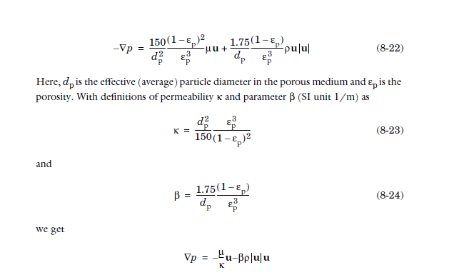

I included a volume force in order to simulate porous media. At flow conditions, the equation that represent it is Ergun Equation ( that could be expressed as Forchheimer eq). My implementation was as simple as :
Where ka is the permeability and b is beta parameter from Ergun equation shown at fig 5.

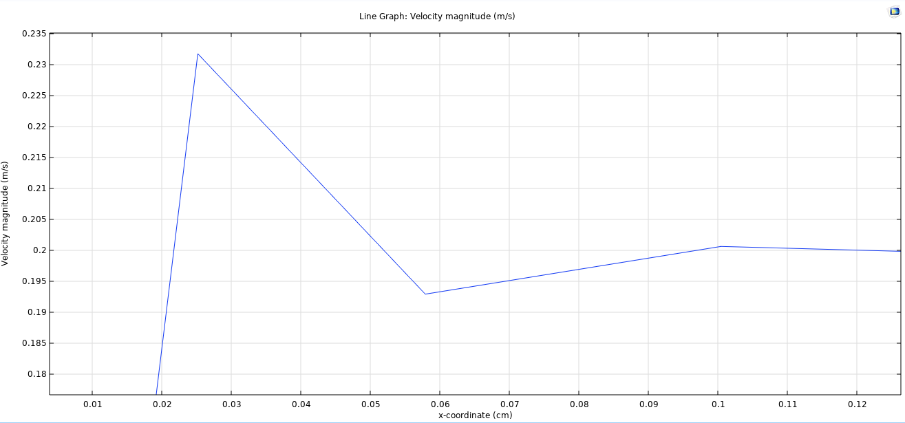

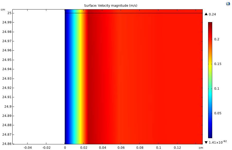

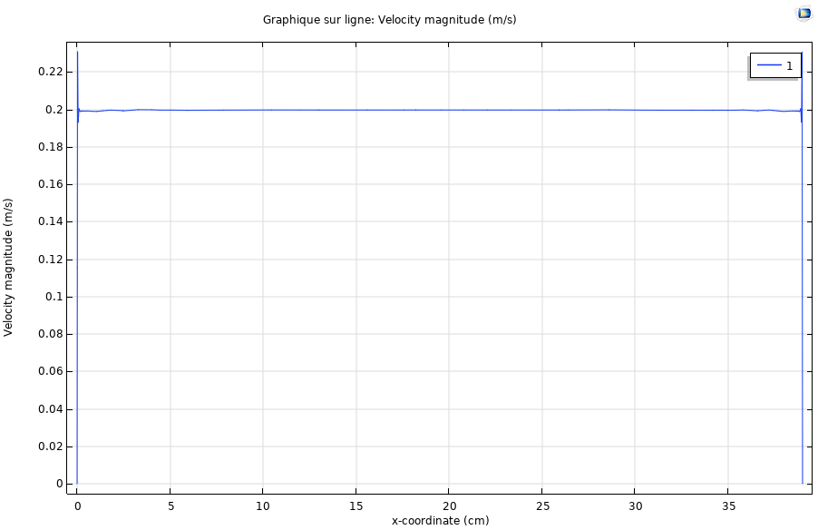

So, when I defined a horizontal cut line in the middle of the bed to see velocity profile, I found a problem because a velocity peak is shown at each side, near to the wall (fig 2 and fig 3). Since properties are isotropic, there no reason for this, so, there is something wrong.

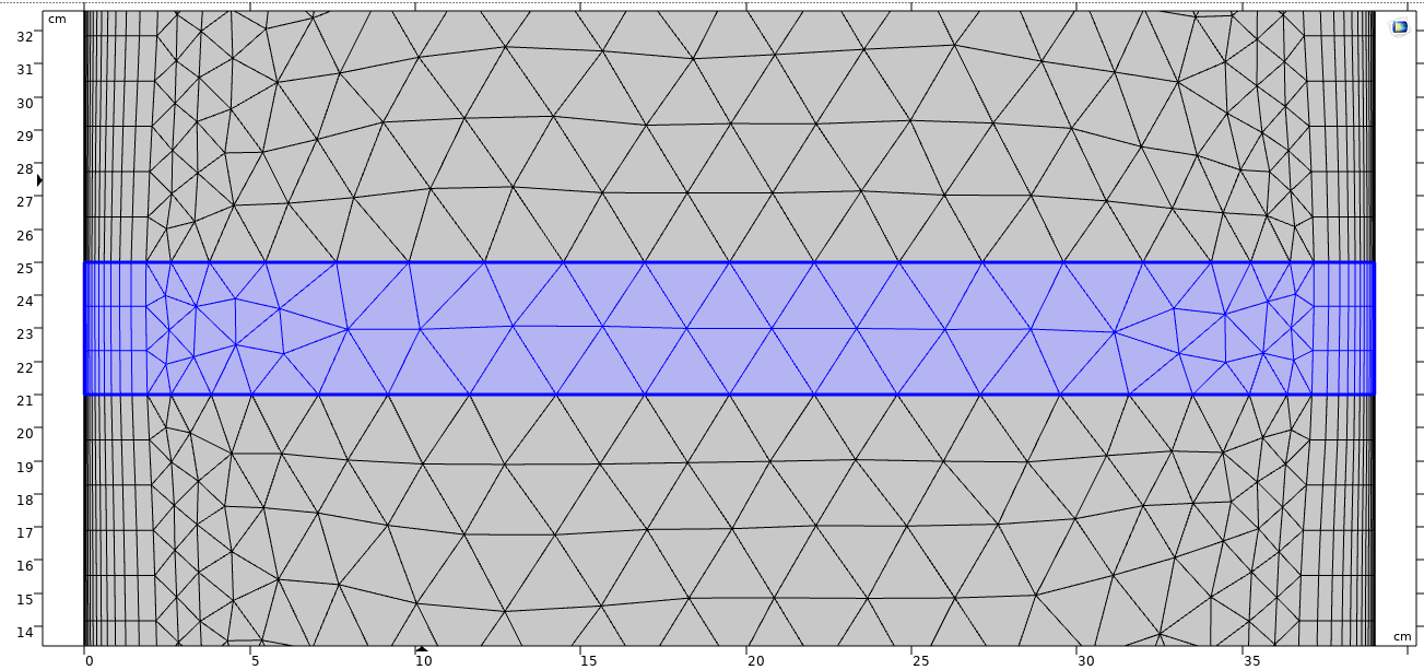

I think it is not a boundary layer problem because I simulated it when having a fully developed flow and with 12 boundary layers (as default), shown at fig 1. Minimum mesh quality is 0.45, which I think is not so bad. I tried also using laminar flow conditions and Fluid and Matrix Properties as default which uses Darcy's Law, but the profile was similar.
