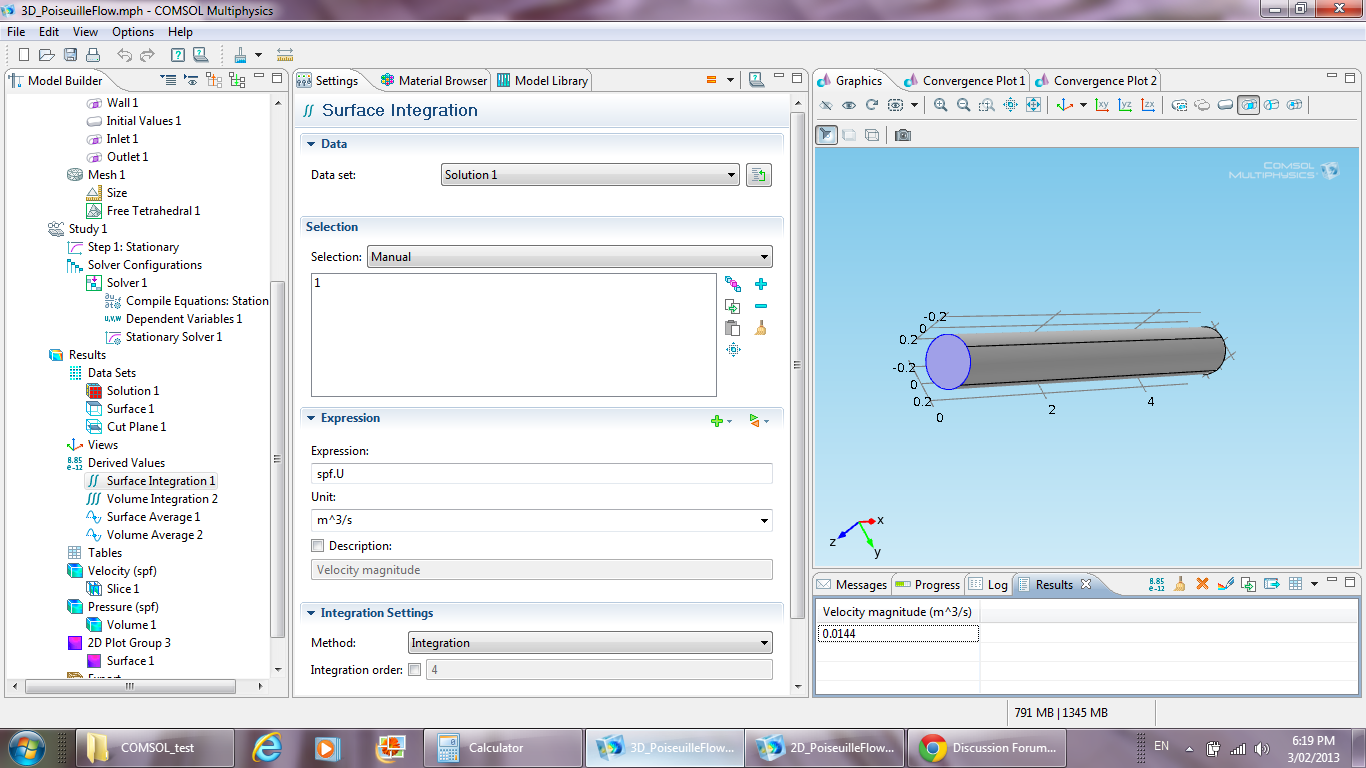

I tried to reproduce what you did to get an idea of how COMSOL calculates flow rate. However, I am also getting two different flow rates from analytical and simulation (nearly 22 unit difference). I went through the recommendations but still could not figure it out where the problem is. Would you please have a look at the snapshot of my model attached and advise me on that?
Analytical flow rate (Poiseuille flow): 0.32 m^3/s
Numerical (COMSOL) : 0.0144 m^3/s -------> using surface integration
I am using v42 and could not find the "compute surface integral" under the Integral setting as Nagi recommended for 2D.
Best regards,
I do not see why it should not give as the anlyitcal results, for me it has always matched, within 10-20%often far better depending on meshing and on model
the 2*pi*r multiplier applies onlyy to 2D-Axi, the option is in one of the Definition Model coupling Integration node sub-tab, closed by default. But you can also easily add the 2*pi*r by hand, so long you do not both, you see the error in case in the units
In 3D a direct integration over the bondary should work, provided the mesh is fine enough to correctly resolve the velocity along the tue axis, and the parabolic profile across the boundary

Thank you so much for your help,
That's right, my mesh is quite coarse on the boundary where I compute the surface integration.
I was thinking that I should get better result (for the same mesh quality) when I am using volume intergration or volume averaging instead of surface integration but still not that much difference!
saeid

Multiplying the radius and the length by 10^-6 gives the same result as analytical method.
