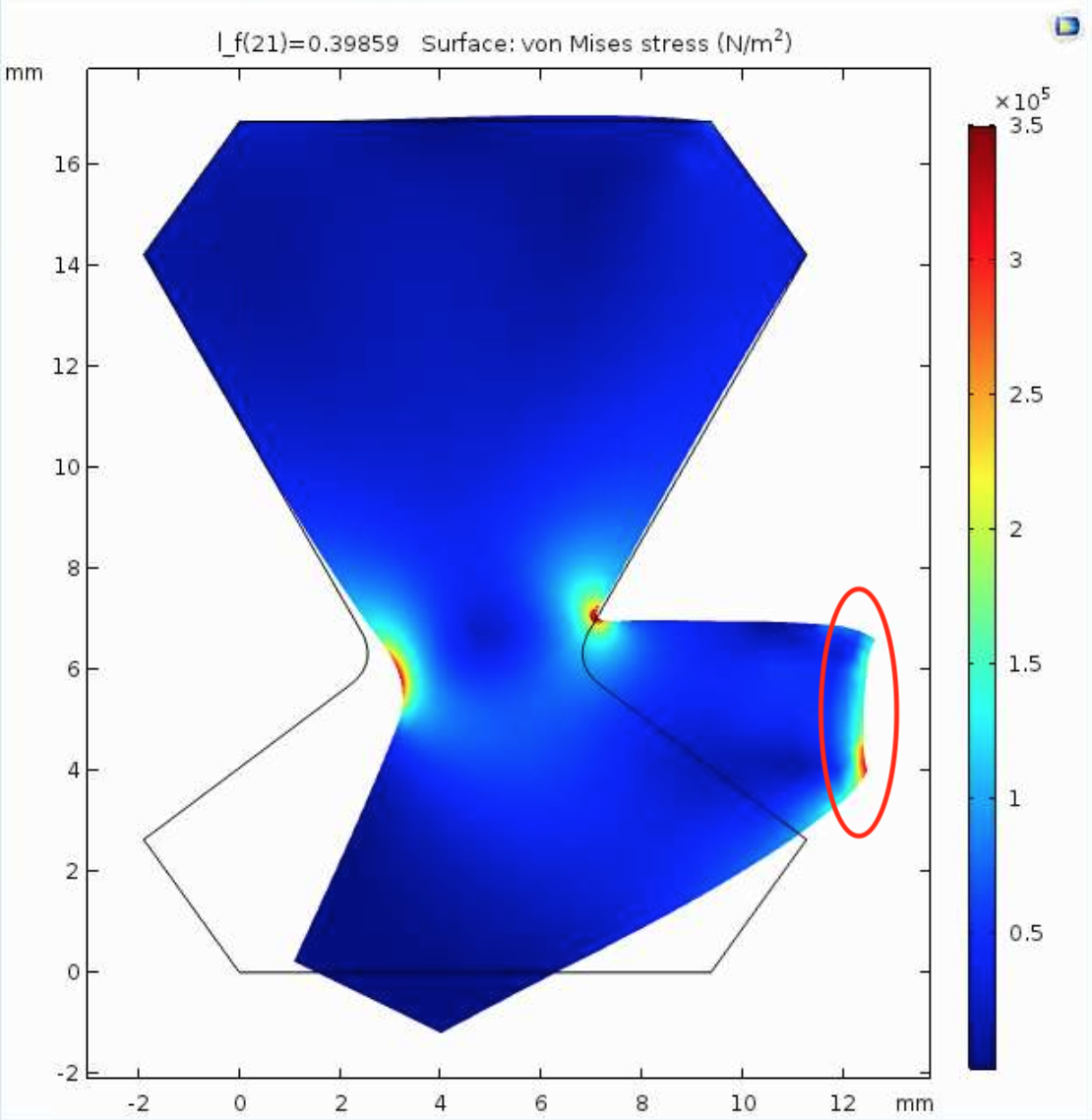

I am attempting to model a flexure hinge subject to bending (see attached picture and model) using the Solid Mechanics module with a stationary study and have run into convergence issues.
For the simulation, I am using an auxiliary sweep with a ramped displacement applied to the bottom right face of the flexure hinge (circled in red on the von_Mises_Flexure_Hinge photo). The issue I am having is the simulation fails to converge around a displacement of 4mm, which corresponds to the deformed shape in the von_Mises_Flexure_Hinge photo. Ideally I would like to be able to model the deformation until their is contact between the two faces on the compression side of the flexure hinge.

- Material: Silicone rubber modeled as neo-hookean (Material Parameters: incompressible, mu = 0.27e6 (Pa), Bulk Modulus 13.4e6 (Pa), and Density 965 kg/m^3.)
- Plane Stress: Thickness 3cm and Quasi-Static.
- Fixed at the top right and left boundaries.
- Prescribed vertical displacement at bottom right boundary.
- Including geometric nonlinearity, auxiliary sweep (0.02 step) to 0-1 cm displacement, predictor: constant, fully coupled.
Trouble Shooting Solutions Already Attempted
- Triangular vs Quadrilaterals Elements - Both fail to converge around the same place.
- Refinement of mesh at joint - Ineffective, I have tried between 5 and 100 element refinement along fillet.
- Solver Type - Segregated and Fully Coupled produce similar results.
- Contact Modeling - Creating a contact pair at the compression fillet does not help.
- Refining Mesh Away from joint - Does not help.
- Linear Elastic Material vs Hyperelastic - Changing the material to linearly elastic does not help convergence.
- Fillet type (Spline vs Bezier Curve) - Changing between does not help.
- Incompressible vs compressible material - For linear elastic material modeling incompressible vs compressible setting makes no difference.
- Decrease joint width - decreasing the joint width helps slightly, but still have convergence issues.
