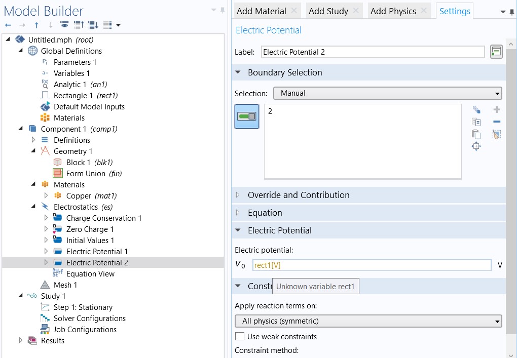

Thank you for your patience Alexis, I am able to change material property in form of function, but in other physics nodes I can't change the variables into a function, it says unknown variable. Same when I try to add a varible as a function in global. I think I am making some simple mistake some where.

I am unsure about how to help you. How are you setting the voltage at the moment? Perhaps consider providing screenshot(s) or attaching your model.

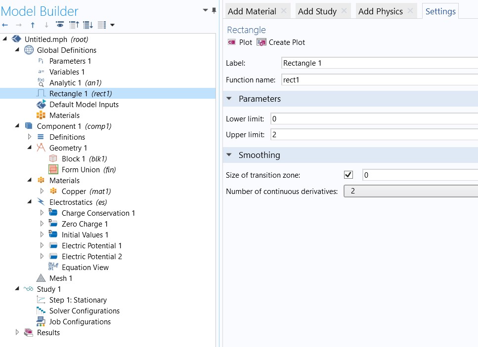

I was able to do this with analytic funtion, but finding difficult to doit with rectangle. By the way using events work like a charm. I am attaching the screencshot of using the rectangle function as potential, probable some error somewhere.
rect1 is just the function name. You must call it with some argument.
For example use V0*rect1(sin(2*pi*f*t)) to obtain a periodic rectangular function with frequency f and magnitude V0. V0 and f can then be parameters that you define (in volts and Hz, respectively), whereas t is a built-in variable representing time.
But I think in your case, the function waveform is more appropriate, because you can directly select Type: Square and Angular frequency: f to get the same result.
Anyway, the point is that the function must be called func_name(argument) by something that is time dependent ;-)
Thanks Alexis, The problem is solved, I was only giving an argument as t, then my unit of potential won't be voltage. It was V*s, that were the problem. thank you very much for your help.
