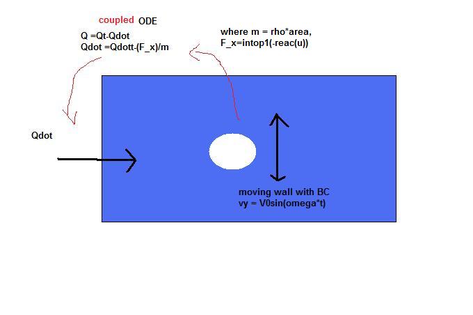

I think I failed to explain my problem clearly. As you know, mine is a 2D spf laminar flow. I have used moving wall BC for an ellipse in body-fitted frame with prescribed y-component of velocity(Please see the attached figure). The x-component of velocity of ellipse is calculated through ODEs. I have used model couplings-> integration and global equations. I have defined a state variable called 'Q'. this is infact position 'x' to avoid confusion with variable names, -this I learnt through one of your earlier posts.
The ODEs were : Q: Qt-Qdot; Qdot: Qdott-(F_x/m). I have calculated F_x using intop1(-reacf(u)) and m using rho_solid*area. Then Newton's equation: mQdott=F_x is supposedly dimensionally correct.
My results (Qdot, ie. x-component of velocity) are varying exactly x2e3 for all parametric solutions with mu=0.01[Pa*s], area=0.07[m^2], rho_solid = 32*rho_fluid, rho_fluid = 200,1000,1600,2000 [kg/m^3].
I am not sure, why there is a constant difference 2e3 for all parametric variations. Did I miss anything in ODE?

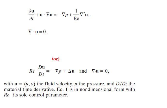

I want to non-dimensionalise Navier-Stokes equation using Reynolds number.
Is there a way to change Navier-Stokes equation in nondimensional form as in the attached figure?
thanks a ton for your helps...

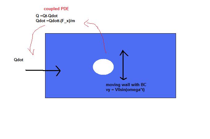

Actually my problem is 2D laminar flow of oscillating circular cylinder. The horizontal reaction force is coupled so that due to vertical oscillation horizontal movement take place. I have created coupled modelling as in the attached figure. My result varies 2e3 times exactly with all paramteric variation.
I was thinking of non-dimensionalising the whole model and run simulation. dont know how to do that.
