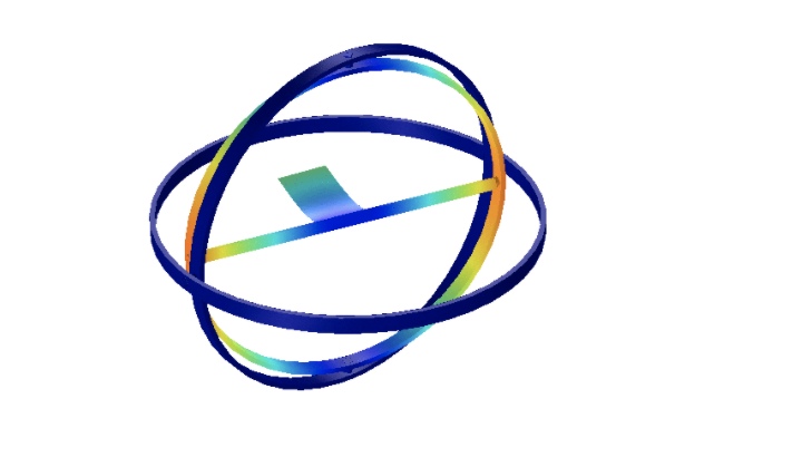

If you are looking for flapping motion with respect to the rotating frame instead of combined flapping and rotation motion w.r.t fixed/spatial frame, you can use Body defining reference frame functionality in the Multibody Dynamics interface. Here the rotating body can be defined as a reference frame and results can be visualized with respect to this frame.

If you are looking for flapping motion with respect to the rotating frame instead of combined flapping and rotation motion w.r.t fixed/spatial frame, you can use *Body defining reference frame* functionality in the *Multibody Dynamics* interface. Here the rotating body can be defined as a reference frame and results can be visualized with respect to this frame.

However, I actually wanted the combined flapping and rotation motion as a function of time (temporal). Any idea on how to do that?
