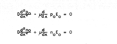

I am defining my system of equation using Coefficient Form PDE . and as you may find from the attached photo, I have 3 dependent variables: n and p (ion species), E (electric field) which are functions of x (position).
could you please guide me through building these equations?
I am confused with the terms, since for each equation the diffusion term only contains either the variable p or n , but the convection term contains also the variable E.
Regards
