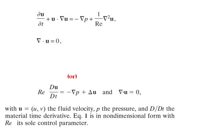

I want to use non-dimensional form Navier-Stokes equation in my 2D spf laminar flow simulation.
The equation in non-dimensional form (using Reynolds number, Re) is attached in the figure. Please some one help me which setting in COMSOL 4.2 I have to change so that it uses one of the non-dimensional form of equation as in the attached figure.
Thanks in advance
Siva
