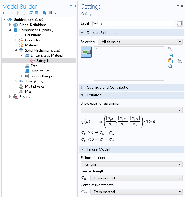

Posted: 5 years ago Oct 22, 2020, 2:36 a.m. EDT
The Rankine criterion is built-in; see the attached screenshot.
