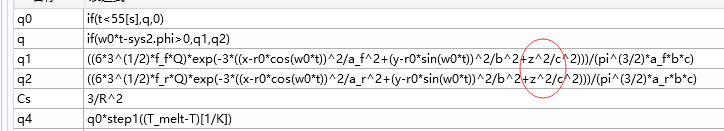

How to realize the double ellipsoid heat source offset left and right along the Z axis
Posted Nov 24, 2020, 4:16 a.m. EST Structural Mechanics Version 5.4 0 Replies
My double ellipsoid heat source can move in the ring direction, but it cannot be offset in the axial direction. I change Z+ or-a certain value, but it can’t be achieved. Can anyone help me see it? Thank you very much.
