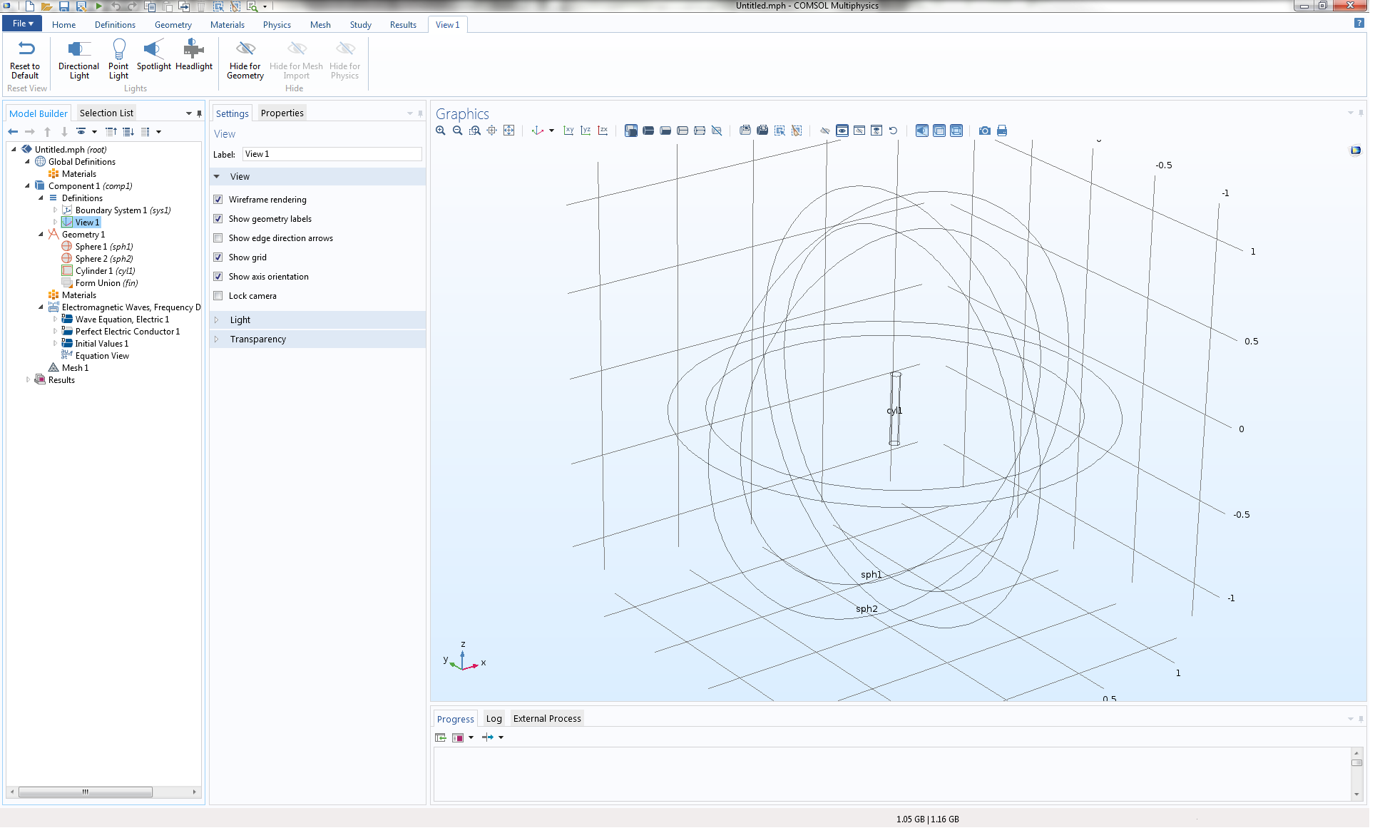

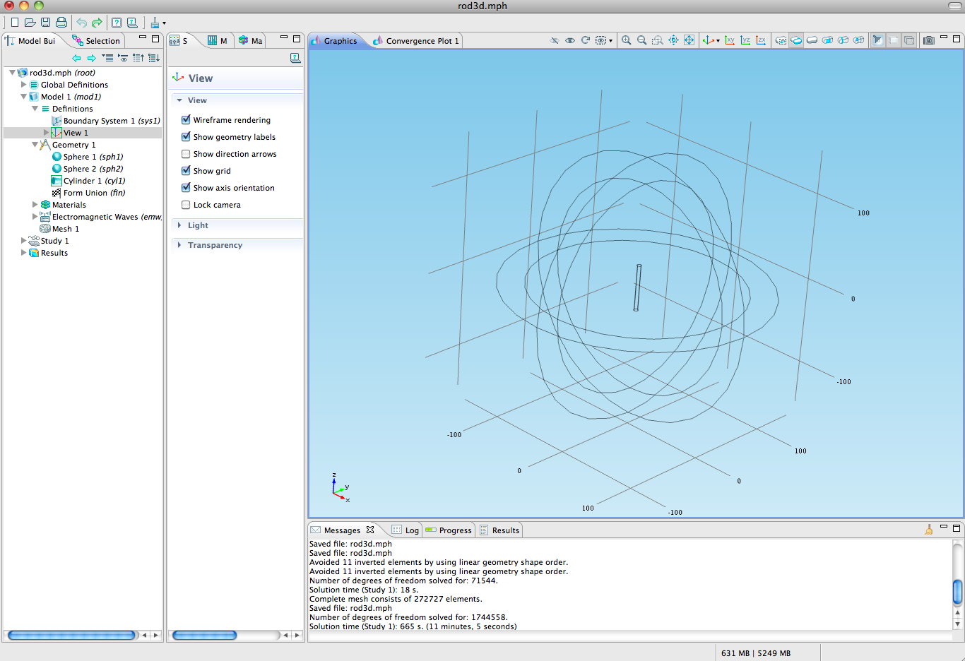

Posted: 1 decade ago Apr 5, 2012, 12:17 p.m. EDT
Attached is a screenshot. I created two concentric spheres, and a cylinder in a new file. Where are the geometry labels? This is wireframe mode. They aren't visible in transparent mode, either. I must be doing something silly.
As far as knowing the "tricks", I'm glad that you know them and you feel they are easy and handy. I've been using Comsol long enough to see the UI change dramatically, which is not conducive to learning tricks over time, as you suggest might be possible for some people.
Attached is a screenshot. I created two concentric spheres, and a cylinder in a new file. Where are the geometry labels? This is wireframe mode. They aren't visible in transparent mode, either. I must be doing something silly. As far as knowing the "tricks", I'm glad that you know them and you feel they are easy and handy. I've been using Comsol long enough to see the UI change dramatically, which is not conducive to learning tricks over time, as you suggest might be possible for some people.

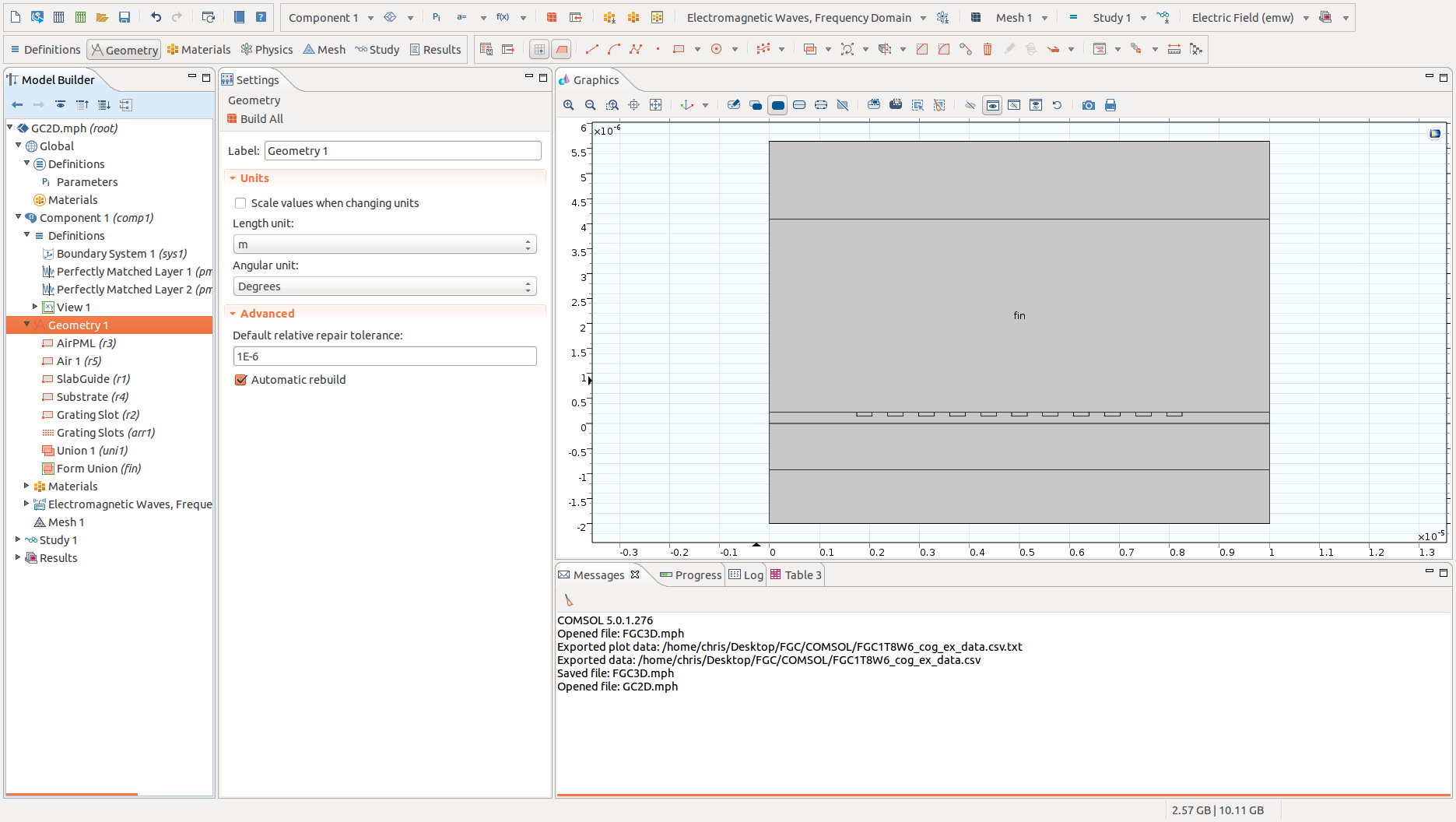

Posted: 10 years ago Dec 31, 2014, 11:55 a.m. EST
Here I am two years later -- with thousands of hours of COMSOL experience -- and I'm _still_ baffeled by this same question. See the attached screenshot. Why does COMSOL display the useless "fin" geometry label rather than the labels for the individual geometry entities? Did I miss a memo?

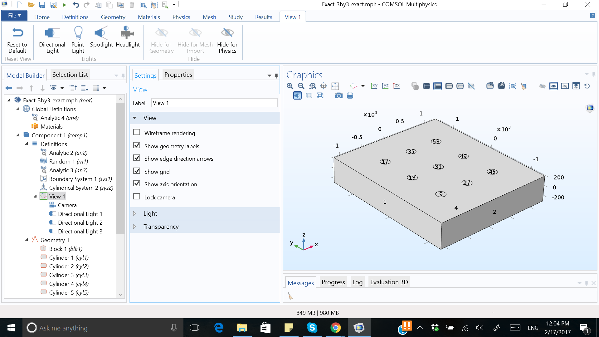

Posted: 8 years ago Feb 17, 2017, 6:07 a.m. EST
Maybe you have already solved your problem if no maybe you can have a look on this.
Posted: 8 years ago Feb 17, 2017, 12:24 p.m. EST
Hello Naseer,
Looking at this thread, Chris encountered a combination of a clear graphics card problem (Demonstrated by his screenshot of April 5, 2012. As a side note, the fact that he had a brand new computer at the time increased, not decreased, the chance that its graphics card driver was buggy) and perhaps a misunderstanding of the interface (His screenshot of December 31, 2014, where it seems he is expecting to see the labels for geometry objects although those geometry objects no longer exist because he's unioned them out of existence).
Regarding Jean-Christophe's post: As for geometric entities, the Graphics window will show domain numbers when you are in domain selection mode (and I have seen this to be fickle in 3D with some graphics cards), boundary numbers when you are in boundary selection mode, edge numbers when you are in edge selection mode and points when you are in point selection mode. Perhaps that was the problem.
I hope this helps future readers of this thread.
Best,
Hello Naseer, Looking at this thread, Chris encountered a combination of a clear graphics card problem (Demonstrated by his screenshot of April 5, 2012. As a side note, the fact that he had a brand new computer at the time increased, not decreased, the chance that its graphics card driver was buggy) and perhaps a misunderstanding of the interface (His screenshot of December 31, 2014, where it seems he is expecting to see the labels for geometry objects although those geometry objects no longer exist because he's unioned them out of existence). Regarding Jean-Christophe's post: As for geometric entities, the Graphics window will show domain numbers when you are in domain selection mode (and I have seen this to be fickle in 3D with some graphics cards), boundary numbers when you are in boundary selection mode, edge numbers when you are in edge selection mode and points when you are in point selection mode. Perhaps that was the problem. I hope this helps future readers of this thread. Best, Jeff
