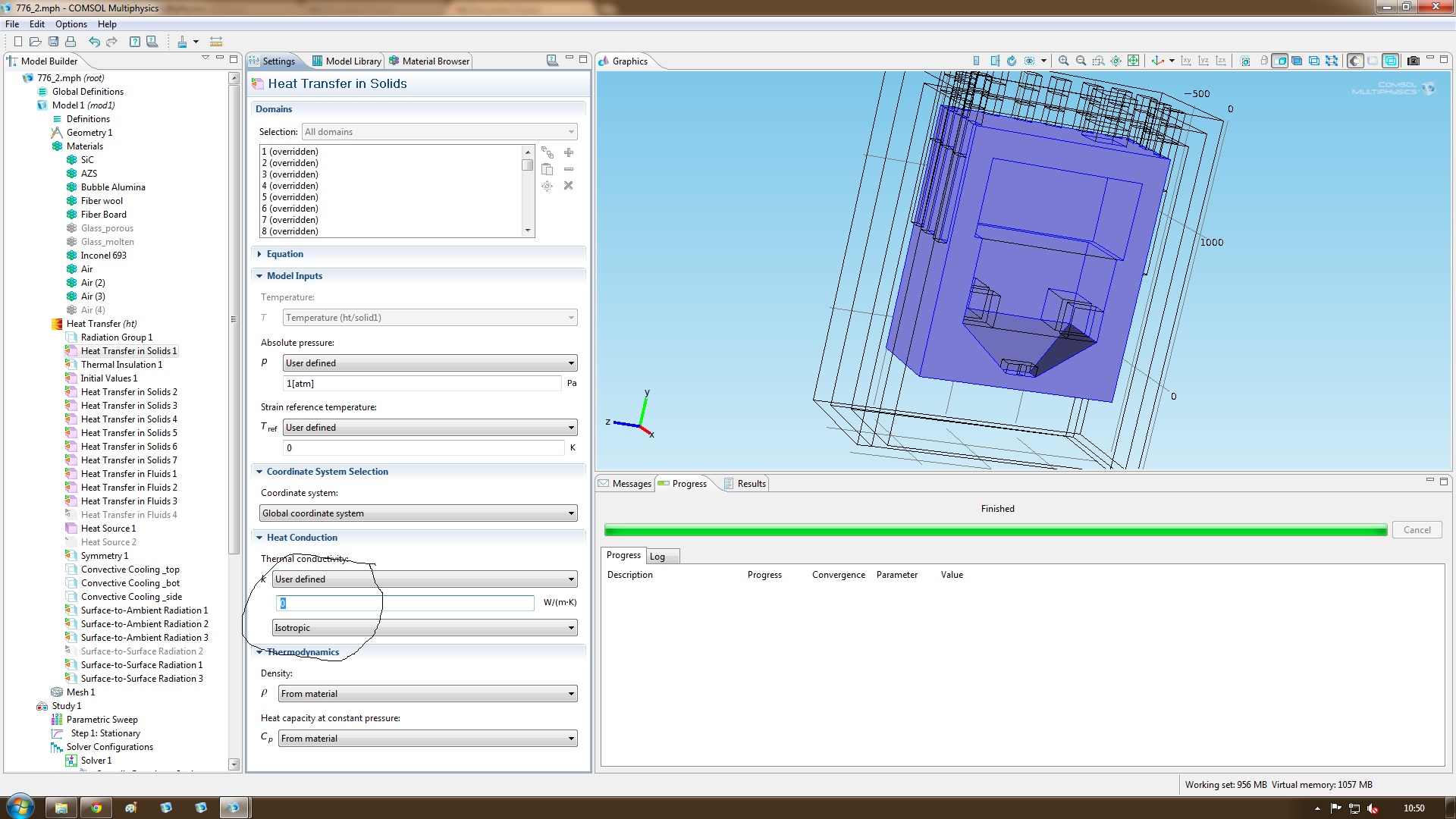

this property should not be given in the material module
Try to use the property value that is present in the physics for the specific domain ...
then COMSOL accepts it.
eg : yi = xi^3/5 + xi^2 where yi being your conductivity and xi being effective saturation and the function being archies law
i guess only the place that you used matters .. !
