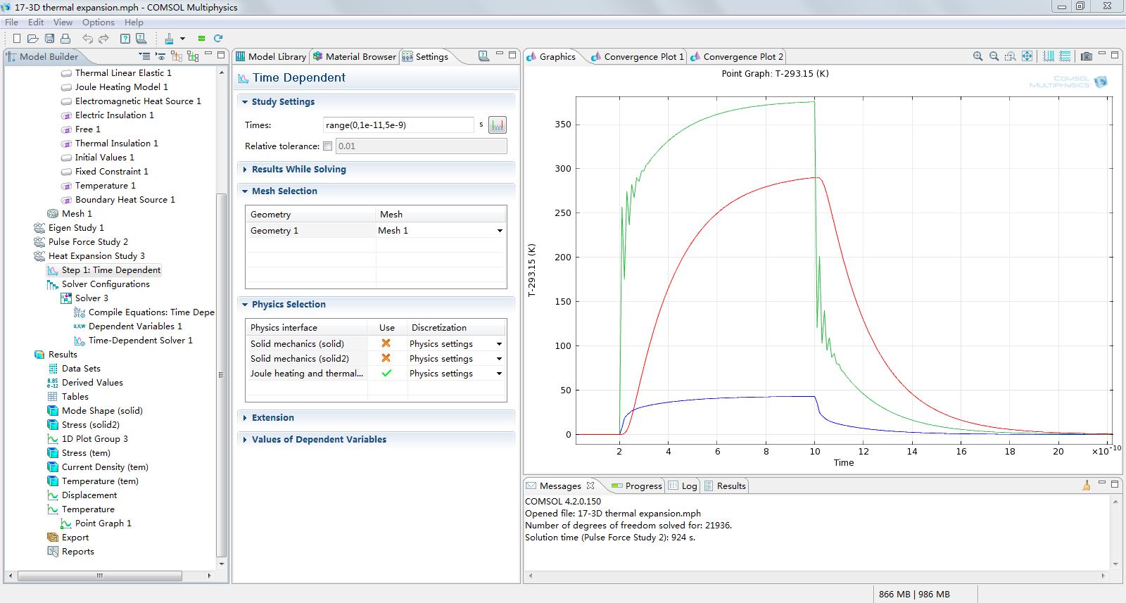

Jagged or oscillating 1D plot
Posted Apr 30, 2012, 9:52 a.m. EDT MEMS & Nanotechnology, MEMS & Piezoelectric Devices, Results & Visualization Version 4.2 1 Reply
I am modelling a micro beam heated by a very short pulse heat input from a small area on the top of it. The attached picture is the temperature vs time plot of points on the beam. It was jagged before I took Ivar's suggestion to change the time stepping from "free" to "strict".
The problem is, even after doing that, the temperature plot still shows some oscillating which shouldn't occur. Anyone get any idea how it happenes?
Thanks in advance
Tianshi
