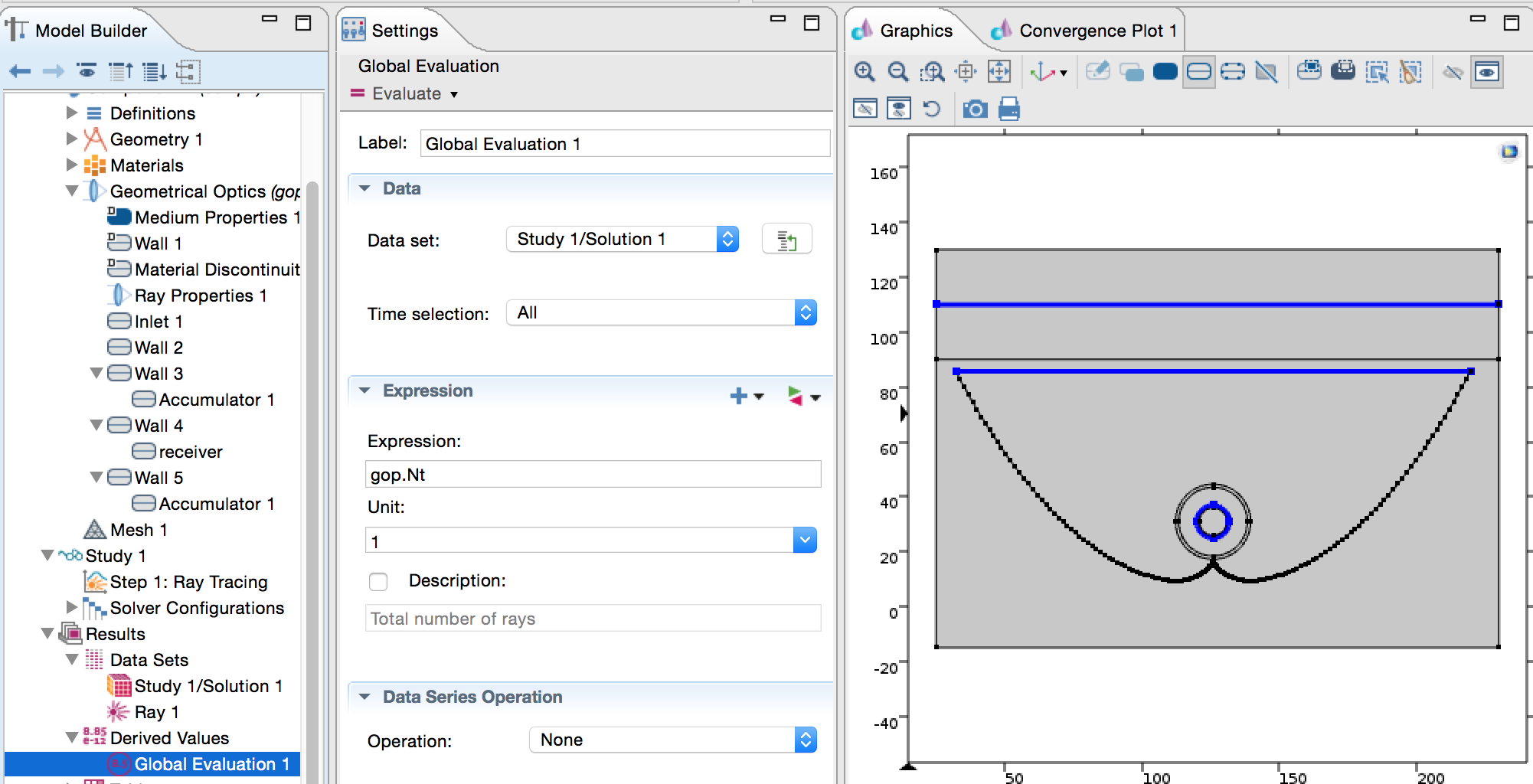

I just figured this out. You should refer to Magnus's answer above, really helpful. Pay attention:
1) The subnode should be under the "Derived Values" node
2) Add a "Global Evaluation" subnode instead of "Particle Evaluation" subnode.

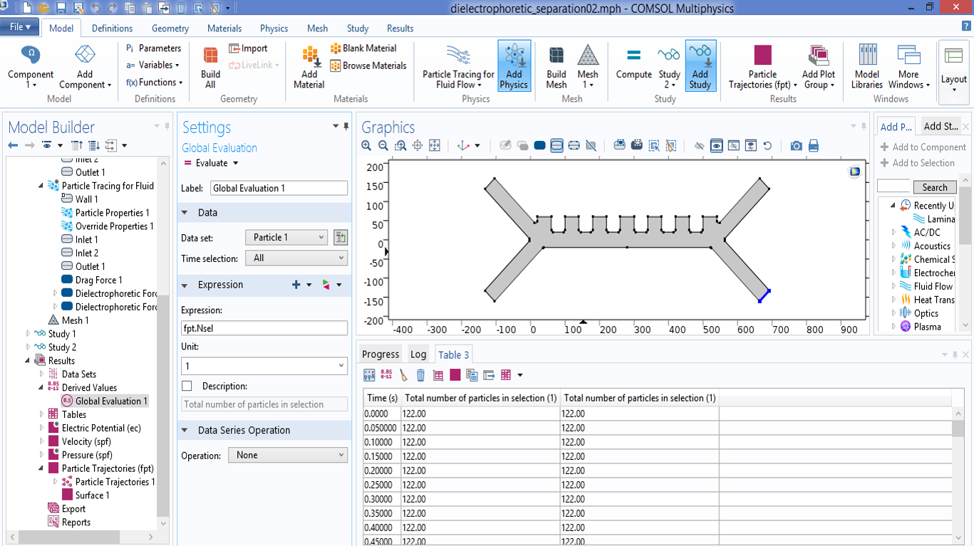

Posted: 1 decade ago Jul 26, 2015, 6:15 p.m. EDT
Hi, I added the node as you suggested, may I know where to get the solution to the particle number? Thank you!
Posted: 1 decade ago Jul 28, 2015, 12:29 p.m. EDT
Under the "Global Evaluation" node, select "particle1" for "Data Set". You need also to add the "fpt.Nsel" under "expression".
Hi, Under the "Global Evaluation" node, select "particle1" for "Data Set". You need also to add the "fpt.Nsel" under "expression".
Posted: 1 decade ago Jul 28, 2015, 5:26 p.m. EDT
Thank you! I did the setting but where I can see the results after computing please?
Also, if I want to count the particle number in a specific region or passing through specific cutting surface, may I know how to do the setting? thanks for the time!
Thank you! I did the setting but where I can see the results after computing please? Also, if I want to count the particle number in a specific region or passing through specific cutting surface, may I know how to do the setting? thanks for the time!
Posted: 1 decade ago Jul 29, 2015, 1:26 p.m. EDT
You can see the no. of particles on the bottom right frame. It will show the result if you click "Evaluate". If you could not see it, try to change the tag of the bottom right frame to "Table 1".
This is basically how to calculate the no. of particles in a chosen boundary. If you want to know the no. of particles in a specific boundary, just choose it. There is also a "time selection" in your "Global evaluation" settings. This indicate the total no. of particles passing your selected boundary from the beginning to your selected time.
You can see the no. of particles on the bottom right frame. It will show the result if you click "Evaluate". If you could not see it, try to change the tag of the bottom right frame to "Table 1". This is basically how to calculate the no. of particles in a chosen boundary. If you want to know the no. of particles in a specific boundary, just choose it. There is also a "time selection" in your "Global evaluation" settings. This indicate the total no. of particles passing your selected boundary from the beginning to your selected time.

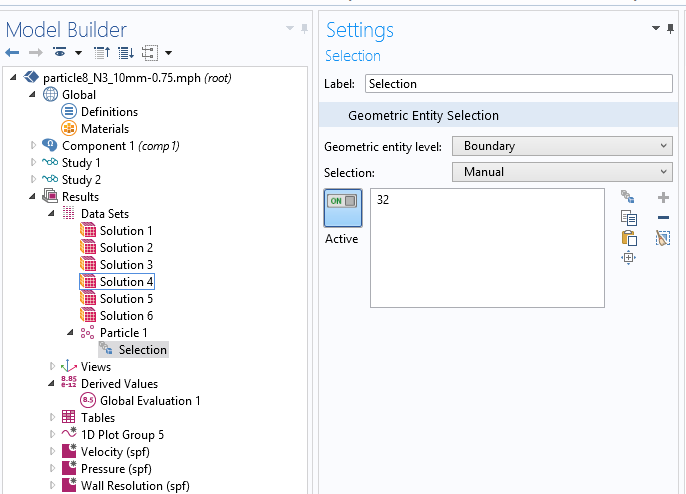

Posted: 1 decade ago Jul 31, 2015, 11:32 a.m. EDT
hi, thank you so much for kind reply. I can get the total particle number in the area now. But it seems I can not select any boundaries. I tried to go to "outlet" node, in which window it allows me to select boundaries. then go back to "global evaluation", and select one boundary, but the evaluation still gives me the total number (attached Figure). May I know how to solve it please? so appreciate your help!
Posted: 1 decade ago Aug 1, 2015, 2:10 p.m. EDT
Please make sure to have this "selection" node under "particles", and choose the boundary you want (see attached file). I believe that is the reason why you only have the total no. of particles.
Hi, Please make sure to have this "selection" node under "particles", and choose the boundary you want (see attached file). I believe that is the reason why you only have the total no. of particles.
Posted: 1 decade ago Aug 1, 2015, 5:12 p.m. EDT
Hi, Jingyuan, thank you so much for the instruction, I finally get the results! Have a nice weekend!

I'm doing something similar only for a ray trace simulation. How do I count the number of rays in a particular wall?
Hi, I'm doing something similar only for a ray trace simulation. How do I count the number of rays in a particular wall?
