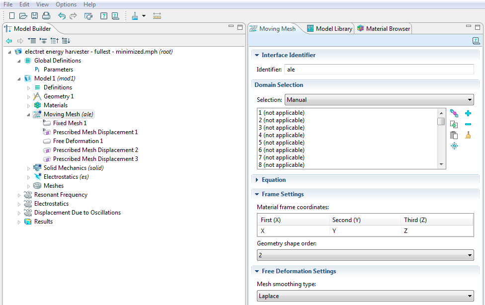

When I set my moving mesh ALE node before the solid mechanics node, all the domains I had chosen in the moving mesh become not applicable. Please see attached screenshot.
Thanks,
Jeff
that is exactly it, Solid has its own frame system so this overides ALE, ALE is for air (which is no solid) domain that is deformed by the solid deformation (check the model library examples)

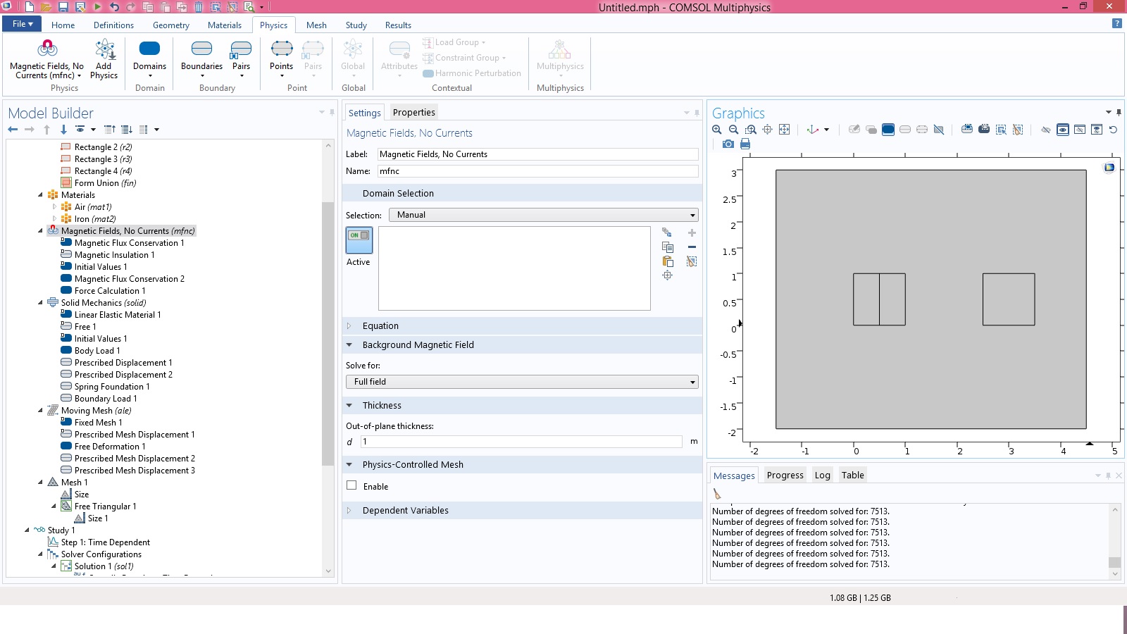

I have been trying to do the same with 2D model witth square shapes. I implemented the familiar steps but result is failure. Can you help me to solve this?
